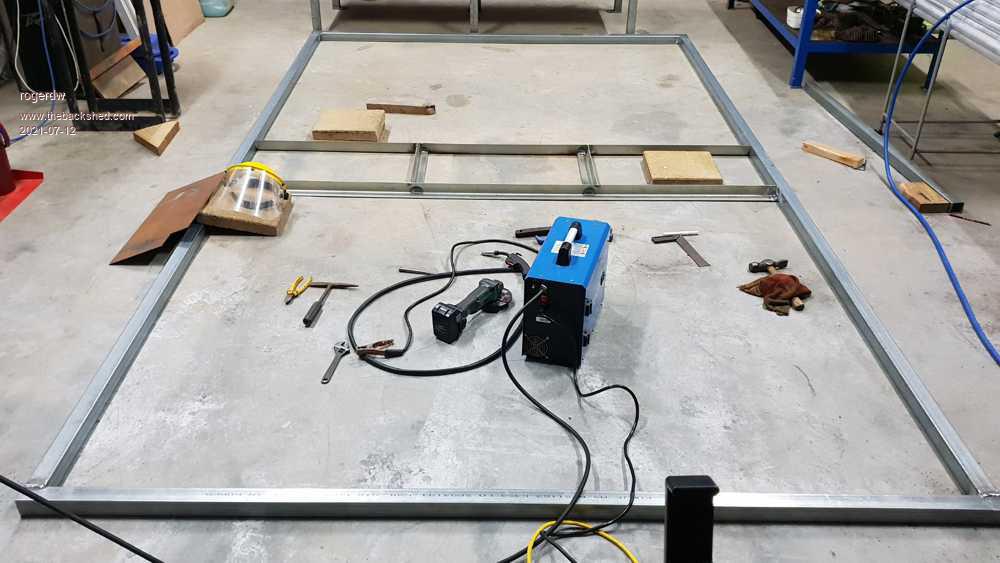

Wife and kids were away for the weekend so I made a plan to get stuck into building the big version for the roof. Had all the main steel for a few weeks but been dragging my feet  ...  plus had to clean up a fair bit to make room to build this thing.
The main frame is 4.1 meters wide by 2.4 meters high and will have the ducting down the centre and with the evacuated tubes sticking out each side, horizontal  ...  60 in total.
Looking at the size of it and realising the weight, I'm starting to wonder how I'm gunna get it up there  ...  might have to call in a few favours.
It's really only the main frame that will be the issue  ...  the rest I will assemble up on the roof.

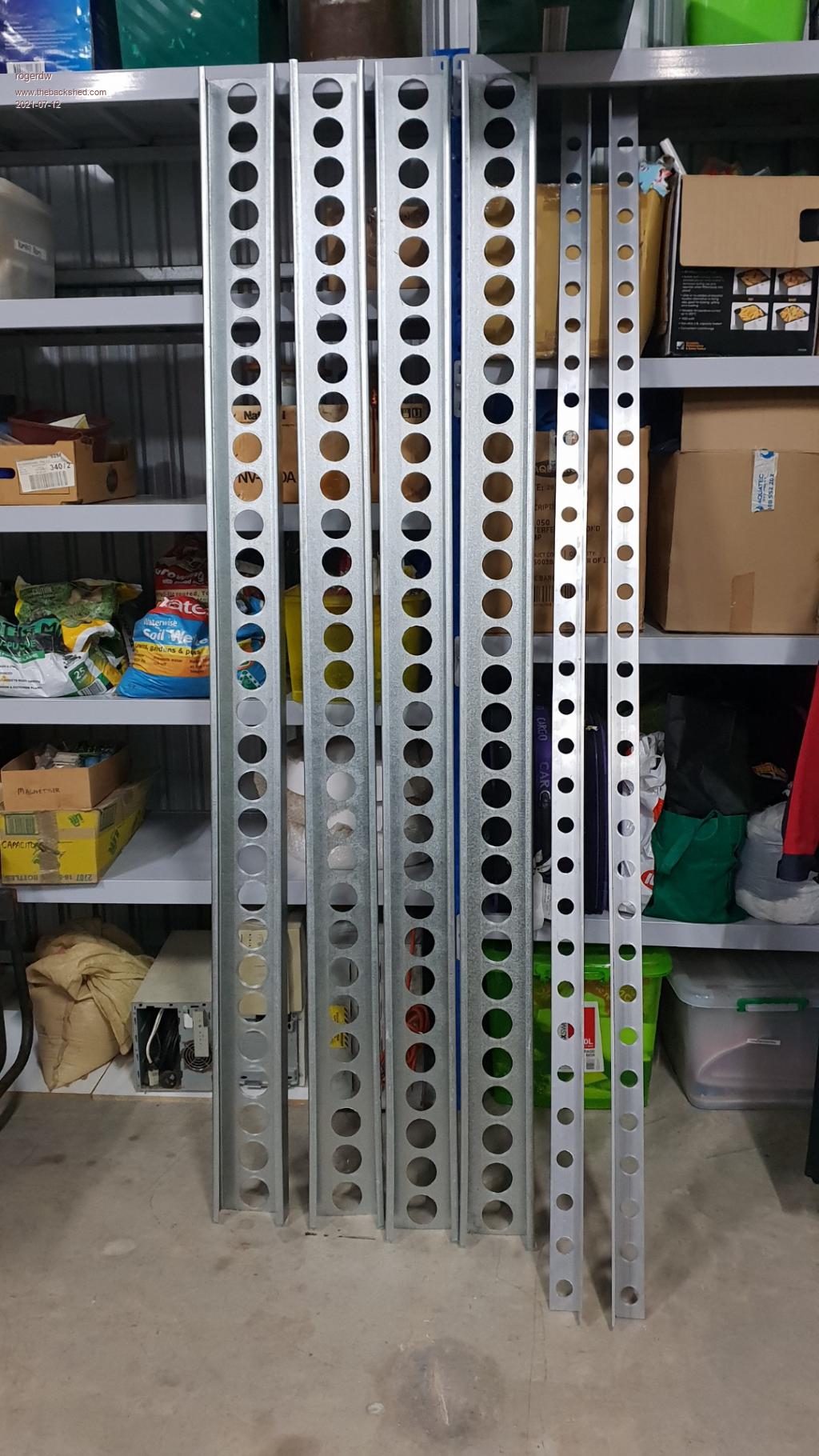

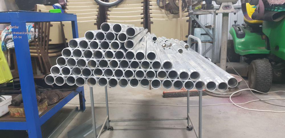

I started by drilling the aluminium angle with 32mm holes to take the ally tubes  ...  then tackled the c-section with 63mm holes. Took a while but very pleased with how it went.
Then I cut up the steel and welded the main frame together. Need to do a lot more welding yet, but its getting there. It's upside down at present.
If nothing else, you can see I'm serious  ...  or mad!!!
I also tried out my new low temp melting point aluminium brazing rods  ...  and discovered the so and so's sold me plain aluminium rods!!! Supposed to melt at 480 degrees, but my tubes were melting before the rods would. So I've ordered from elsewhere, hopefully with better luck this time.

Roger, I can't see how you "drilled" those big holes so neatly. Did you do what I would, drill a 10mm pilot hole and then use what's called a 'chassis punch' to remove the remaining material?
rogerdw
Joined: 22/10/2019
Posts: 957
Posted: 08:40am 13 Jul 2021
  Murphy's friend said  Roger, I can't see how you "drilled" those big holes so neatly. Did you do what I would, drill a 10mm pilot hole and then use what's called a 'chassis punch' to remove the remaining material?
I did drill pilot holes, though only about 5mm  ...  then used a holesaw to create the holes.
I screwed a guide block to the drill press table then slowly did each one.
I was going to try kerosene or even WD40 when I did the aluminium  ...  but when I was in Bunnings I spotted a spray can of cutting oil put out by Suttons, who also happened to have made the holesaw set that I have  ...  so I used that for all of the holes and it certainly went well. Was $19.95, so expensive  ...  but seemed to help.
Took all evening to do the aluminium angle  ...  had them clamped back to back  ...  so the saw had to go through 12mm of metal.
The C-section I clamped back to back as well  ...  so halved the setup time in shifting it through. Those took pretty much all day to do.
I was amazed at the swarf coming off the cutter. If I fed it in properly I could get a curly piece a couple feet long before I backed off, blew away the swarf and lubed it again.
Got a nice box full of washers now.

Yeah, in my naivety I thought I'd just buy some aluminium filler wire and weld up the pipes with my oxy. Well I found out the hard way that that wasn't going to work  ...  so I bought what was supposed to be those flux cored brazing rods  ...  but weren't!
  Quote  If you were doing plenty of this it Might be worth looking at getting a Spool gun for your MIG. I guess as this is likley to be a one off, probably not worth it but hey, He whom dies with the most toys.....
Probably unlikely to do much ally welding in future, especially if these rods work as well as they claim.
What I really should do is go get some welding lessons so I have a bit of a chance  ...  but I've managed this far and I need to finish this job first.

Posted: 10:38pm 13 Jul 2021
Getting back to the aluminium welding.
I bought some of those trick aluminium brazing rods to try, and they do work very well with just a propane torch. Only two disadvantages, they are bloody expensive, and the aluminium must be in perfect pristine degreased and unoxidised condition.
But for fresh new store bought aluminium. it works great if you can get enough heat into it.

  Warpspeed said  Getting back to the aluminium welding.
I'm relieved to hear that Tony, hopefully they will do the job when they get here.
My tubing is secondhand, though I think it was all offcuts from new material and is in good shape. I have buffed the ends and it has come up beautifully.
  Quote  But for fresh new store bought aluminium. it works great if you can get enough heat into it.
Perfect for one off small jobs, but doing repetitive brazing to heavy gauge sections will be very slow and use up an unbelievable amount of propane and those (solid gold?) brazing rods.
Mmmm  ...  so can I use the oxy to heat it or do I need to get some propane?
And in my naivety, I wondered if I preheated the join area somehow close to temperature and then used my hot air desoldering gun to do the job. The melting point is supposed to be 480 degress and the hot air device goes to 550. I know, dreaming!!!
  Quote  As you have discovered, aluminium filler rod and oxy acetylene torch definitely does not work.
Haha yes, though that is what I used to join all the pipes for my first device. I didn't take any photos because they'd be too embarrassing to show  ...  but they did stick together. Though a lot of them would have a lot of globs of metal inside where it started to cave in!!!
  Quote  ANY type of aluminium welding requires pure argon (available from Bunnings).
Bunnigs are good, because you pay only once for the cylinder without any ongoing rental costs. It costs nothing to keep an argon bottle in the shed for years. You pay only for the refills.
That argon will also work very well with a MIG welder welding either steel or aluminium.
Ok  ...  so I forgot to address that in my reply to Dave.
I do have a bottle of Argon which I bought when I bought the welder  ...  and it came from a place where I was able to buy the bottle outright and just pay for refills when needed  ...  ie. no bottle rental.
  Quote  Aluminium wire is obviously very soft, and it does not feed well through a normal MIG hose, so you really do need a spool gun for aluminium wire.
Whoops, I'm definitely out of my depth here  ...  I just assumed if I wanted to go down that track I'd just buy a roll of aluminium wire to put in the machine. Now I understand what Dave was saying.
  Quote  Your best bet for welding aluminium is argon plus a TIG welder. That is nice and slow, and with a bit of practice its possible to make good strong welds either with or without a plain aluminium filler rod.
If you buy an electronic Chinese TIG and and a Bunnings argon bottle, you can weld both aluminium (dc) or steel (ac) with it. And its excellent for welding either very light gauge sheet metal, or very heavy sections.
Okay  ...  well I do have an electronic Chinese MIG/TIG plus my argon bottle  ...  and I did actually try using the TIG with the first lot  ...  but I made such a mess of my attempts that I went back to the oxy and did a far better job.
I definitely need some lessons.
Incidently, I did speak to a friend who is a welder and does amazing work with aluminium  ...  but his eyes went all funny and he developed some sort of tic  ...  so I didn't actually have the courage to ask him if he'd weld them for me as a paid job.
If these other rods don't do the job, I'll go back to him and have another go.
The photo isn't that good to see, but the ends did polish up well  ...  no corrosion or pitting.
Cheers,  Roger
