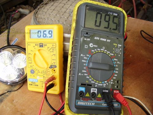

Saturday voltage readings

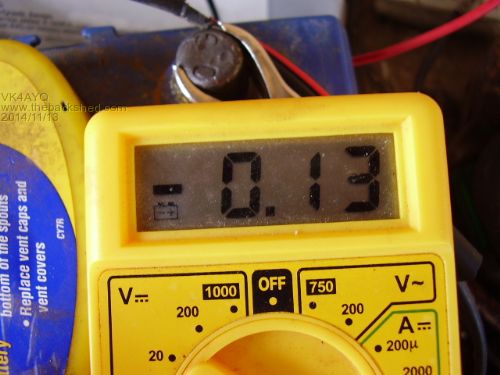

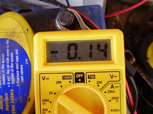

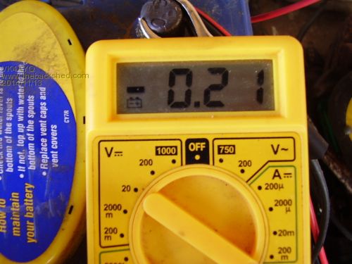

Well the batteries have settled at what looks like their own voltages, and it is still possible to pull the 9 watts of power out into a led light.
Saturday morning
Saturday afternoon
As you can see the voltages have stabilized at well below Lead Acid levels, this is possibly due to several faulty cells, I have left them on charge overnight so till now Sunday lunch time they are still drawing current and have charged to 14 volts, I will put them on the pump 12 volt solar system for a few days and see what happens.
I won't bore you with any more voltage readings as i think the point has been proven for the ALUM experiment.

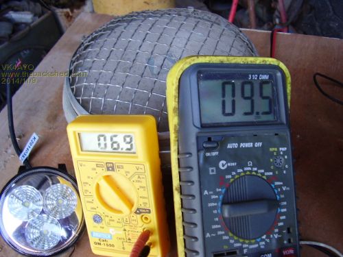

I tried the battery with a load this afternoon with the 9 watt load it was good but the 150 watt load killed it but it recovered and kept the 9 watt load going so at < 1 amp it is usable but more than 10 amps it drops to 4.5 volts. About as much good as a hip pocket in a tee shirt.
All the best
Foolin Around

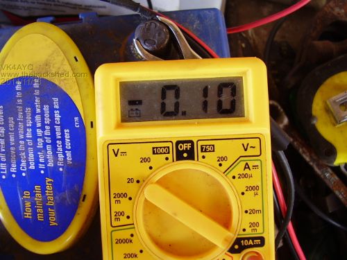

The battery is now connected to the pump batteries and I am waiting for a sensitive ammeter to measure cross current to see if it detracts from or adds to the use of the batteries a initial check with a multi meter showed a small charge current to bring the battery up to the 13.5 volt float but under load from the pressure pump I cannot detect any current flow back out of the battery when the pump cuts in, which I suppose is logical as the battery has a normal standing voltage of 10.5 volts against the lead acid batteries voltage of 13.5.
I will leave it there as it seems to do no harm and then hook it to the light circuit in the next week or so when I can put an isolater relay run of the light connection on the regulator to isolate it at night.
All the best
Foolin Around
VK4AYQ
Joined: 02/12/2009
Posts: 2539
Posted: 10:52pm 12 Nov 2014
Hi All

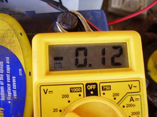

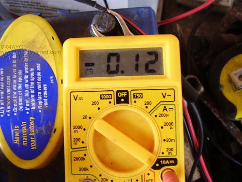

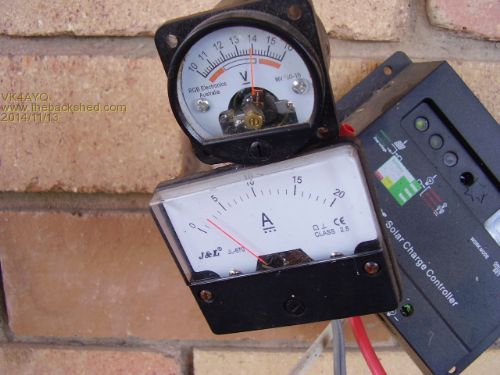

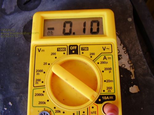

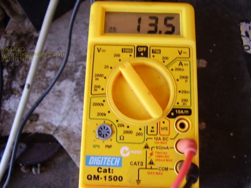

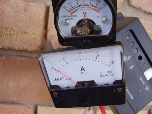

I connected the battery to the pump batteries this morning before solar input, it was at 10.4 volts and the system voltage was 13,4 volts.
It initially drew 280 MA from the system unfortunately my camera decided not to go so I didn't get the initial reading, by the time I changed battery in the camera it had settled down a bit.
The overall voltage dropped a very small amount.
Note no solar input at this time about 6 AM
The input settled to 140 MA once again no determinable voltage drop on the pump batteries.
The input by now had dropped to 100 MA. 8 AM.
As the solar started to kick in the system voltage rose and the input to the battery started to increase, 9 AM.
Then the current draw started to drop back indicating the battery was fully charged.
A slight spike upward as the regulator went into equalization mode at 10 AM
Dropped back when floated down to 14 volts 10:30 AM
Then dropped back to 100 MA once battery voltage normalized.
As the day went on the input remained fairly constant and when the pump was running dropped back to nearly zero but no evidence of the battery supplementing the pump batteries.
All in all it has confirmed my idea that it is a side loader on the system and wouldn't contribute any current unless the system dropped below 10 volts which it never does.
So to try to use an ALUM battery with lead acid is a waste of time, I will try to use it to run lights on its own by using an isolator relay, that will pull the light load of the pump batteries overnight.

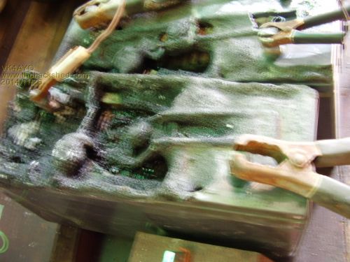

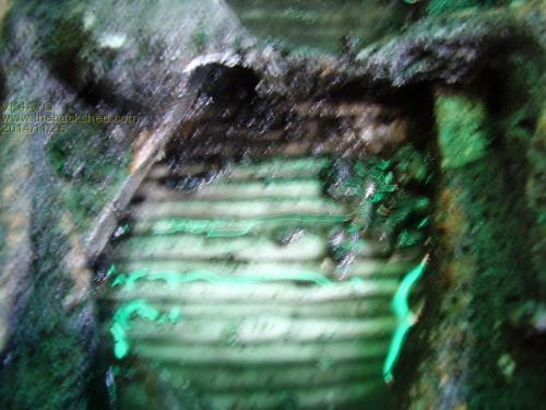

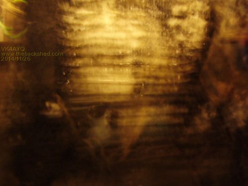

I am cleaning out some rubbish in my shed and came across the two batteries that where burnt in the shed fire I had several years ago, they have been sitting under the bench covered up wit junk for nearly three years now and as you can see are in a very sorry state,
They where actually on fire and I manage to put them out along with rest of the fire or my shed would be gone.
On closer examination after I ripped all the burnt plastic and ash of the top of the plates, I thought it may be a good idea to explain the membrane I mentioned earlier in this adventure, if you look closely you can see a wrapping of spongy fabric around the plates and over the top of this is a sheet of plastic which in this case got burned beyond recognition.
This form of construction holds all the shed plate material and will not allow the flushing process to get rid of the grunge, while it is good for the long life of the battery it precludes the flushing and changing of electrolyte to ALUM such as I tried with the batteries several weeks ago.
Sorry if this bores you but I thought it would explain the situation with enclosed plate packs.
I have cleaned the batteries up as much as I can re-hydrate them and will see if they can be revived with a desulphator, I will let you know how that goes, maybe ugly but might be usable.
All the best

The gutter guard should be fairly cheap if one wants to experiment.
Iwonder if the stainless would hold the charge like the lead dose?

I had to run the battery clear grave yard dead to make it
easier to reverse the polarity.
When you run a good battery down and let it set he battery will
bounce back on its own and that is why I had to draw it down
as far as I could .
I wonder if this process would help clean the gunk off the plates?? ''
