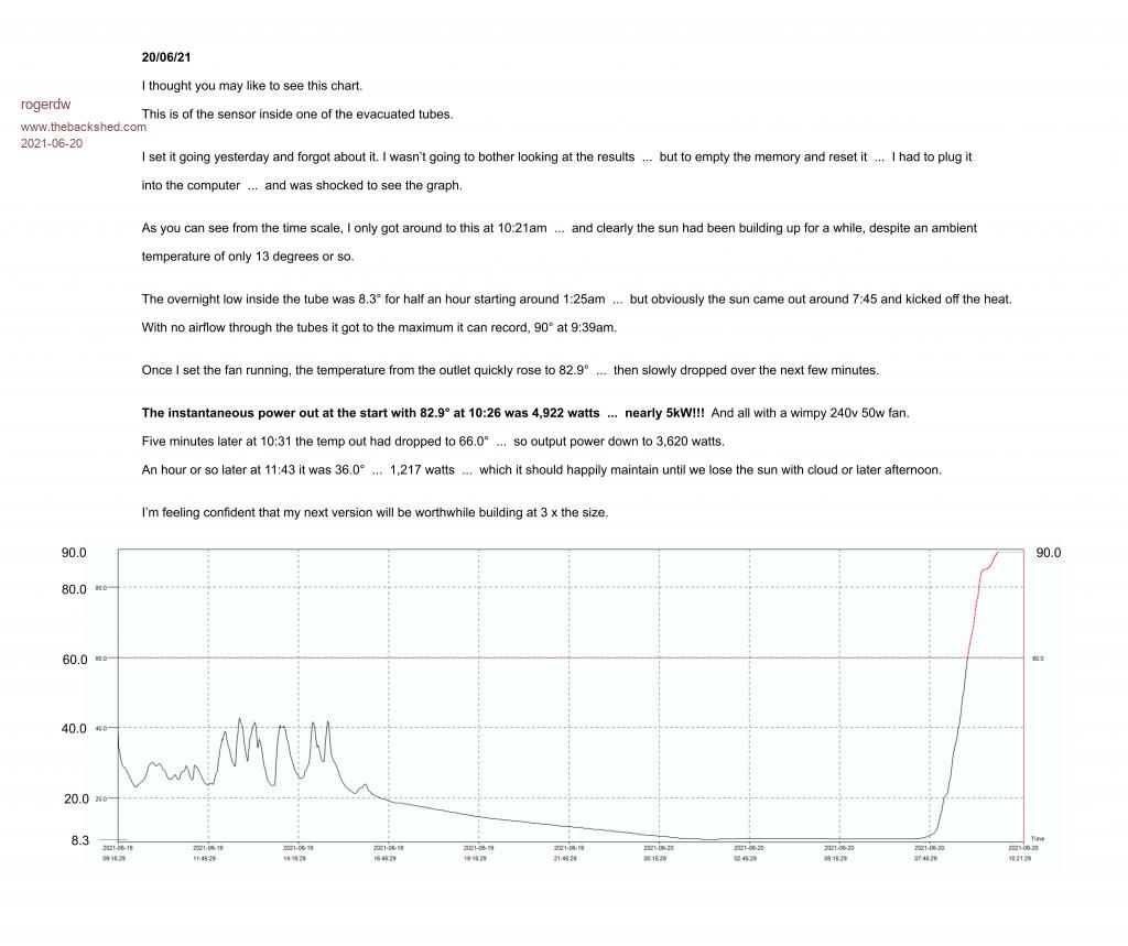

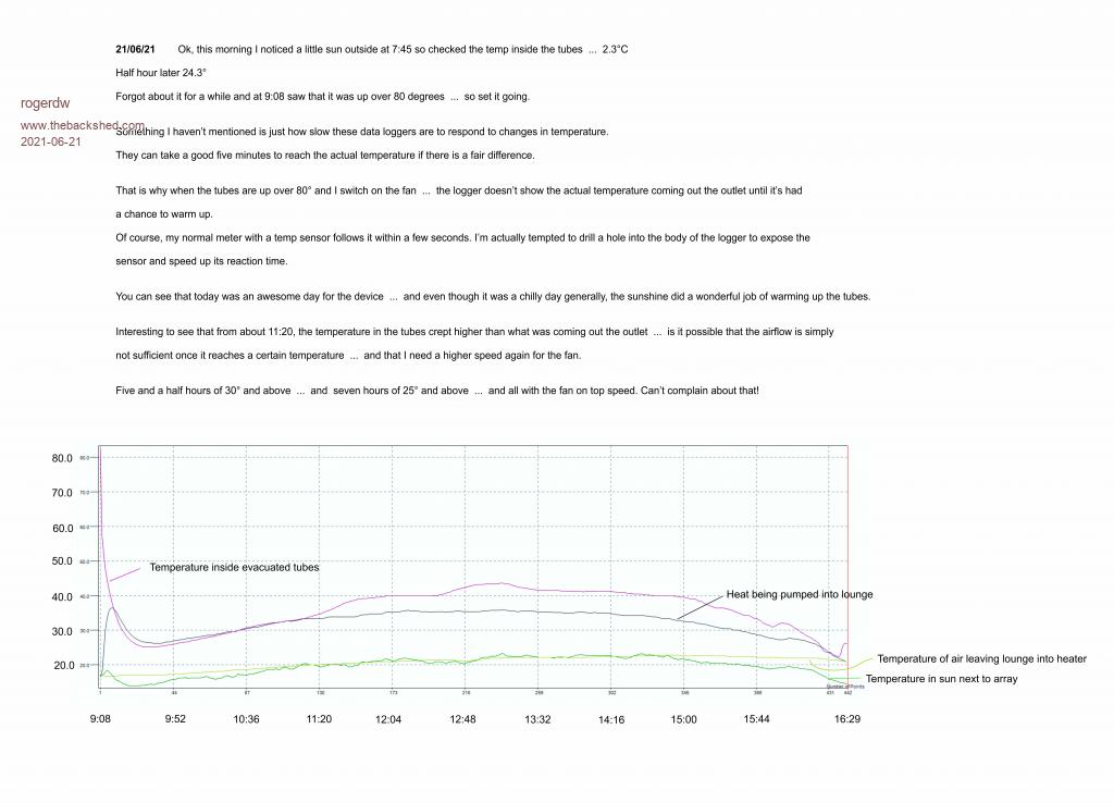

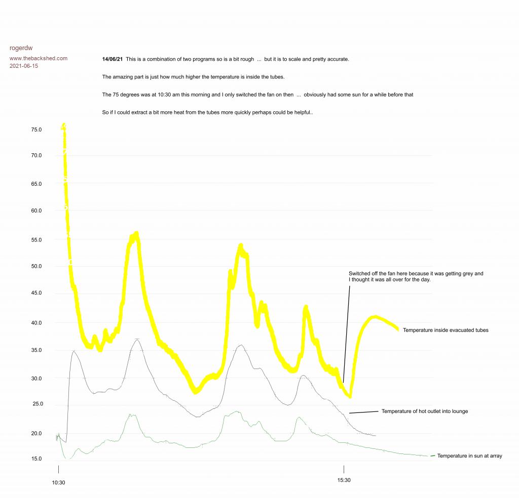

I've been a bit quiet here lately  ...  got behind with my paying work by spending too much time playing  ...  and had to knuckle down for a bit to try and catch up.
Had a fun experience today when I came in for luch. The unit had been off for the morning coz it was pretty dark and grey  ...  though by lunchtime was improving.
I switched on the fan and was instantly hit with a blast of hot air. Over a couple of minutes it climbed to 73 degrees  ...  and then took five minutes to drop to 60.
At the 14 minute mark it was at 46  ...  then floated around 38-39 for another 25 mins or so because the sun came out. Then slowly dropped to 25  ...  so I turned it off otherwise I'd have got back into my work and forgotten about it  ...  and then pumped the place full of cold air.
I really need to fit some auto controls  ...  but still trying to decide how to go about it.
I had thought it needed a variable speed motor to follow the available heat  ...  but after a few experiments of turning it off completely  ...  waiting for the heat to build up  ...  then running the fan flat out to pump all that heat in before it drops too low  ...  then off and repeat.
The jury's still out on that one.

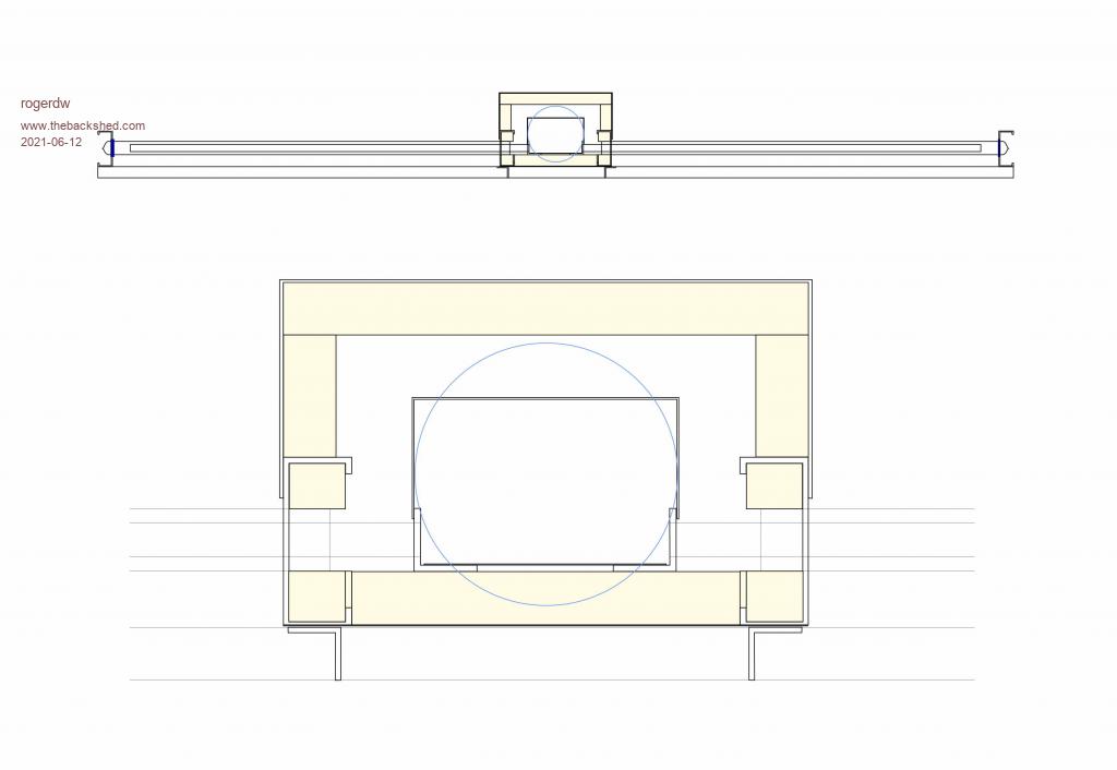

And the hardest part at the moment is working out how I'm going to go from my rectangular ducts to a 10 inch round outlet.
Cheers,  Roger
Posted: 09:34pm 11 Jun 2021
For the middle duct, you can buy both plastic and sheet metal cable ducting that has a removable lid. Available in a variety of sizes and very easy to work with.
Edited 2021-06-12 07:38 by Warpspeed

The design is very clever Roger.
You should have a lot of heat going through there. From what I can see you have wisely made the centre the hot air but I don't know if it's worth insulating the outer casing as well? I spose any heat transmission ends up in the same place in the end.  Maybe you should paint it black to try and pick up another degree of heat and increase the surface area by that much. :0)
The rectangular to round fitting shouldn't be hard to get at an AC suppliers. I have seen them. Depends what the sizes are as to if they have them as a fitting but they do make custom still all the time. Been with and to pick up stuff for my mate. They can knock it up pretty quick as well as it's everyday work for them.
I had a like a half plenum made years ago so I could cut a slot in the ceiling and recess a paper holder up there. Was going to box it in with  gyprock by mate said get this made and then just put it up there and paint it.  Came up really well and was cheaper and a heck of a lot easier than doing the gyprock.
There is a Plastic Duct brand my mate uses called " Aussieduct".  If My mate uses it, must be good. It's actually called " Trunking" generically and is mainly used for cabling and pipe cover.  The AC profile would probably be a bit small for what you want at only 100MM but there is another one that's 150x 75 which may flow a bit more air which I think you'll need with so many tubes.

  Warpspeed said  For the middle duct, you can buy both plastic and sheet metal cable ducting that has a removable lid. Available in a variety of sizes and very easy to work with.
Haha, now you tell me. Thanks for that info Tony  ...  if I'd have known about it I certainly would have considered them.
I had frequented the local salvage yards looking for something to use, but knowing I want to braze the aluminium tubes onto or into it  ...  there weren't too many options.
What I settled on was to use two lengths of aluminium angle and braze the tubing directly into holes cut in that. Then use them as the backbones of the duct, with a flat sheet joining them at the bottom and a cover bent up for the top.
  Davo99 said
You should have a lot of heat going through there. I spose any heat transmission ends up in the same place in the end.  Maybe you should paint it black to try and pick up another degree of heat and increase the surface area by that much. :0)
Mmmm  ...  I'm not sure if I do have it right or not, but the plan is to have the cool air blow in through that central duct and straight down through the ally tubes and back up inside the evac tubes bringing the heat with it.
Then the hot air is forced into the outer space, which is insulated  ...  and out the other end.
Some of that heat is going to be lost/absorbed by the central duct carrying cold air  ...  but it is also preheating the cold air  ...  so I didn't think it was worthwhile insulating the two. Besides each lot of insulation bites into the duct volume and I wanted to keep that as small as possible.
  Quote  The rectangular to round fitting shouldn't be hard to get at an AC suppliers. I have seen them. Depends what the sizes are as to if they have them as a fitting but they do make custom still all the time.
That's very handy to know, thanks Dave. I had given up on the aircon guys because I couldn't even buy simple duct fittings from our local suppliers. Looks like I'll need to make some calls and go to Adelaide probably.

I bought a supposed datalogger multimeter  ...  an Owon BT41T, which I have been using to monitor various temperatures etc  ...  but it's really a crap system as far as I can work out. Actually thoroughly disgusted in it to be honest.
The data recording works via bluetooth to a suitable device  ...  eg a mobile phone  ...  but of course as soon as the phone goes out of range or there's a hiccup  ...  the recording stops and unless you're on the ball the whole effort is wasted.
Being a holiday today, I left my phone alongside the meter for the day so finally got some worthwhile readings  ...  but then it's a major pain to extract anything from that data.
I finally just screenshot the crude graph the phone shows and photoshopped it into my normal system just to highlight how hot it gets inside these tubes.
I do have a question if any of you boffins know  ...  what program can I use to graph my figures. They are presented in excel  ...  but I could not make that show a graph  ...  too many data points I think.

I've given up on the data logger side of the Owon meter for the time being.
I ended up doing what Klaus suggested and modified one of my Elitech loggers by removing the temperature sensor off the board and fitting it to the end of a longer lead so I could get it down into an evacuated tube.
The temperatures I get from down inside the tubes are now within a few degrees of what comes out the outlet.
Before, they seemed to be around 10 degrees higher using the Owon and its temp probe.
When I removed the probe, the fibreglass sleeving has started to show signs of browning already (after about a week) ...  so must be pretty hostile inside the tubes.
I need to post a few charts showing the new comparisons  ...  but in the meantime  ...
Cheers,  Roger

Another great day today  ...  Five and a half hours of 30 and above  ...  and  seven hours of 25 and above  ...  and all with the fan on top speed.
There was a frost this morning and when I turned on the heater at 9:08 this morning the ambient temperature was only 8.1  ...  yet the tubes were up over 80 degrees C already.
Cheers,  Roger

Out of interest, what temperature comes out of that heater?  ...  coz mine of course is down between 25-35 most of the time  ...  so even less likely to make a difference.
I haven't recorded the floor temperature much at all like I intended  ...  I really need to do it more often so I have a baseline to compare with when I try the blanket.
Because ours is on a slab too  ...  I expect the heat to just 'disappear' when I try it  ...  the question being whether it slowly increases the temperature of it over a week or so  ...  or not.
