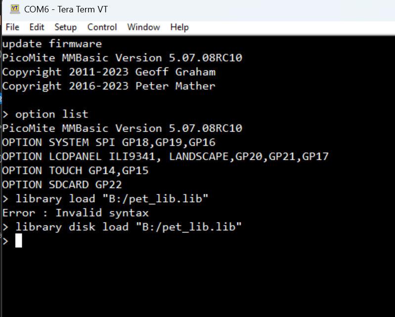

Please post the library file in question and your complete option list when trying to load and exactly which firmware version you are using - suggest you re-download from Geoff's site before anything else.

  matherp said  Please post the library file in question and your complete option list when trying to load and exactly which firmware version you are using - suggest you re-download from Geoff's site before anything else.
the Lib file is in the Zip  Archve, Bleep posted yesterday.
I posted the PicoMite version in the Error message:
library delete
> library disk load "LCDLIB.BIN
Error: Invalid address - resetting
PicoMite MMBasic Version 5.07.08RC10
Copyright 2011-2023 Geoff Graham
Copyright 2016-2023 Peter Mather
so it is PicoMite MMBasic Version 5.07.08RC10
I don't know which version Bleep is using
Edited 2023-10-19 19:23 by Martin H.

Posted: 10:20am 19 Oct 2023
Loads perfectly for me using the RC10 in the download from Geoff. Also tested on VGA version with no issues
UPDATE: loads but won't run as the index of sprite addresses seems wrong. Line 342 fails with invalid dimensions i.e. the w and h are out of range
