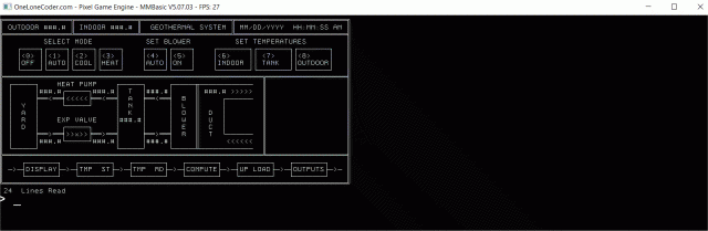

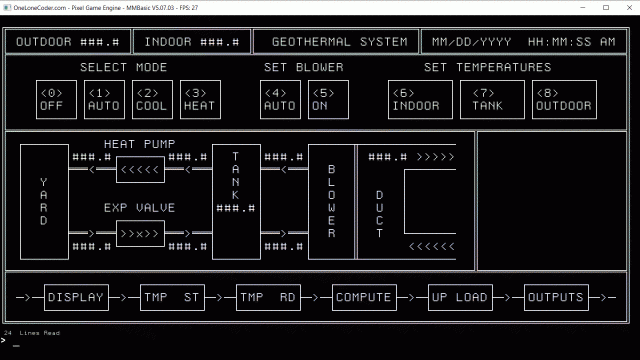

Puzzled by need to set first line printed with TEXT at other than 1 in order not to have top lines scrolled off.
For Paul_L's display using PC graphics drawing characters, when using scale to make the display as large as he wants, I have to set the first line at 7 when scale is 2, or at 13 when scale is 1. The program sets mode 16 and font 4.
Display with scale=2, first line is 7 (this is the way Paul wants it to look):
Display with scale=1, first line is 13:

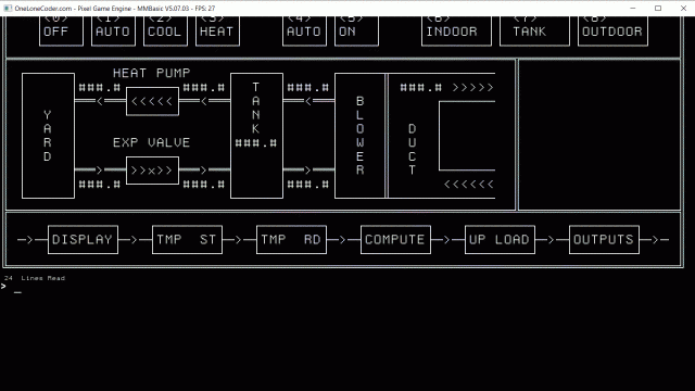

Here's what it looks like with scale=2, first line = 1 (it's similarly off the screen with scale=1 and first line = 1):

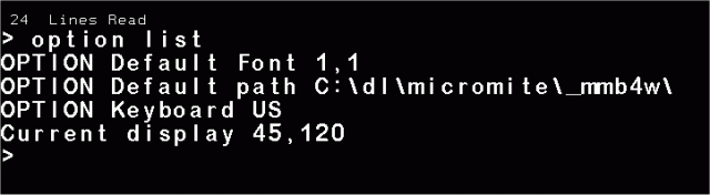

Here's the result of OPTION LIST:
If it's significant, my display resolution is 1600x900.

Posts: 12040
Posted: 02:51pm 04 Jul 2022
This is a known issue and happens when the mode size is >= to the actual physical display size.
Try setting the mode to a minus value to use full screen mode or chose a mode smaller than your physical screen

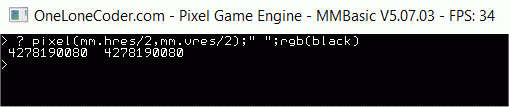

One of the Challenge '22 programs written for the CMM2 didn't display properly in MMBasic for Windows. It wrote some invisible text, then read it back pixel by pixel, and if the pixel was non-black (<>0) wrote it in another place as a sprite at maybe 8 times the size.
Under MMBasic for Windows, it wrote sprites for all pixels, whether blank or not. When I looked at what it was reading as PIXEL(x,y) for what was expected to be a blank pixel, I got 4278190080. I tried writing a pixel as RGB(BLACK) and reading it back and got the same value.
I got the program to display correctly by checking pixel value <> RGB(BLACK) instead of <>0.
My question is, what is the reason for RGB(BLACK) not being equal to 0 under MMBasic for Windows?
Posts: 12040
Posted: 01:29pm 27 Jul 2022
  Quote  My question is, what is the reason for RGB(BLACK) not being equal to 0 under MMBasic for Windows?
Because that would have a transparency of 0 and wouldn't show as the windows is always ARGB8888
Posts: 3885
Posted: 02:36pm 27 Jul 2022
Ah, I see. Thanks.
If I print ? hex$(rgb(black)) I get FF000000. That makes more sense than printing it as decimal.

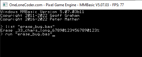

Thank you Peter, you've fixed that, but a recent addition to the MMB4L firmware test-suite has revealed another issue:
Running this will immediately crash-out MMB4W, note that it is crashing out whilst loading the program into the program memory not whilst it is interpreting it.
I believe it should instead be generating the error "Name too long" during interpretation.
