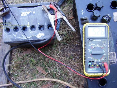

As I suspected this battery is a worst case exercise, after six flush baking soda and charge cycles it has become apparent that the baking soda isn't doing the job, the plates are enclosed in a membrane so it is not getting in good enough, so today I took a different tack, after draining upside down for 12 hours a gave it a charge of water and a high voltage charge for 30 minutes flushed it again then added 3 heaped teaspoons of washing soda to each cell, it bubbled away happily for 30 minutes then settled down to slight bubbling half an hour later I checked the voltage and it showed 10.1 volts so it looks like I have a alkaline battery, I will leave it overnight and flush in the morning then add the ALUM and see what happens.
The concept I believe is working but it will now depend on how much active material is available as to the capacity it will deliver, the recommendation is to cycle charge and discharge a number of times to set the alum and plate combination so more work there.
I wouldn't do one of these semi sealed batteries again as the membrane makes it neigh on impossible to clean and desulphate the plates.

Hi All
Morning report the battery settled down overnight, no more bubbling in the cells and voltage settled at 8.5 volts, I put it on the boost charger and it accepted 20 amps before it would accept only 5 amps so that is positive, There was quite a bit of grunge in the water so it got another clean out. I will leave it on the boost charge for a couple of hours and then flush once it is hot, I think one more flush and boil up with plain water and I will hit it with the ALUM.

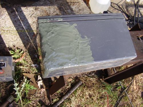

HI Isaiah
A photo of the resealed battery, I had to do it twice as there was a leak through the porosity but it looks OK now.
I have refilled all four damaged batteries and now included them in the battery bank for a equalization charge.

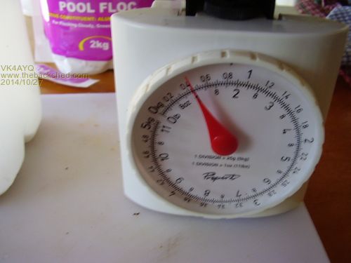

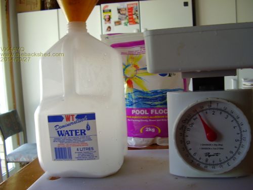

Battery number one is now filled with ALUM electrolyte but it dosen't look to promising as it is only taking a small conditioning charge, the indicated volts off charge 11.5 volts but Not much capacity at this point, according to the experts it takes four or more cycle charges to get the capacity up so once again time will tell, I will leave overnight tonight and do another cycle tomorrow.
Preparing the electrolyte.
I used a four liter bottle of water to 400 grams of ALUM by weight.
I heated the water to make it dissolve the ALUM faster.
On filling the battery bubbled strongly and evenly across the cells, one hour later it settled down to a slight bubbling across all the cells, I then put it on the trickle charger and all the cells started bubbling evenly again so it is all active all that remains to do is to cycle it a few times and see if I can get any worthwile capacity.
All the best

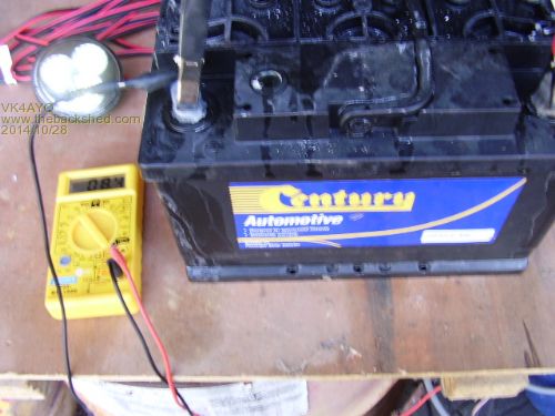

Battery number two run the light for eight hours overnight and went down to seven volts where the light dropped out, so it seems that the best output voltage is between eight point five and seven point five volts.
Battery number one sat on nine volts without load overnight and this morning run the light for several hours. On both batteries there has been a increase of activity after the first cycle but it brings into question as to how useful these batteries would be with the low voltage, before they had none so it proves it is an improvement but is it a useful improvement for all the work gone into them.
I think that the concept of getting an old battery from the scrap heap and making it into a new useful battery is busted, as both these batteries where from the scrap heap, both nine plate 50 AH batteries and the best they demonstrate so far is low voltage and around 10 AH for battery number two and 4 AH for battery number one, a few more cycles may improve the AH capacity but the lower operating voltage limits their usefulness to running LED lighting system or some other low voltage application.

I just went and checked the batteries and found they are holding at 9.7 volts when i took them off charge they where 11 volts and that sagged to 10.1 volts after several hours, according to what I have read they have a cell voltage of 1.75 volts with Alum so that is much as expected, I tried the 150 watt load and the went down to 3.5 volts so they cannot take the load, I have now connected a 10 watt load to see how long that goes for. it indicated to me that internal resistance is high as the energy is there but it cannot get out to the load.
An interesting point to note is that when I was trying to desulphate them they where running the 150 watt load for a couple of minutes even though the where buggered so there internal resistance was lower with the acid than the ALUM.
I think the only way to be accurate about the conversion is to get a new battery and check its load capability then drop the acid and do it again with ALUM and compare the results.
From what I have seen with these two batteries I believe that if I had put the same amount of work into them to clean and desulphate them They would have been more useful but still for all intents and purposes buggered.
I have some less buggered batteries to try when the weather comes a bit more favorable but I am not optimistic of a good result, it make me wonder on conversions I have seen on the internet as to how real they are and if the method has any merit.
