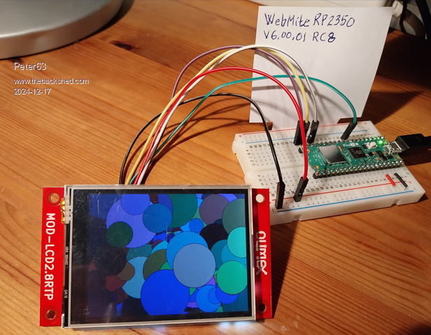

Posted: 04:27pm 16 Dec 2024
Hello, from Sweden
I have tested this display, works OK. But how do I connect cables for touch?
Peter

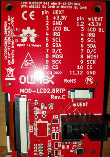

homa
Joined: 05/11/2021
Posts: 719
Posted: 04:40pm 16 Dec 2024
@Peter63
I got this from the website:
- LCD uses SPI, touch uses I2C or UART
- Touch is handled by NS2009 or AR1021 depending on hardware revision
https://www.olimex.com/Products/Modules/LCD/MOD-LCD2-8RTP/open-source-hardware
https://github.com/OLIMEX/MOD-LCD2.8RTP/blob/master/README.md
5 - SCL 6 - SDA I2C pins used for touch component
But the whole thing would be better off in its own thread.
Matthias
Edited 2024-12-17 02:44 by homa
Peter63
Joined: 28/07/2017
Location: Sweden
Posts: 217
Posted: 05:12pm 16 Dec 2024
Hello
U2 chip is the NS2009, for touch I2C
GUI TEST LCDPANEL works OK
I'm going to test some more, and see if I can get the touch function to work...
Peter

Posted: 05:39pm 16 Dec 2024
if I understand the datasheets right, then there is no IRQ for the touch available on the connector. This would reduce usability a lot. But I may be wrong....
73 de OE1HGA, Gerald

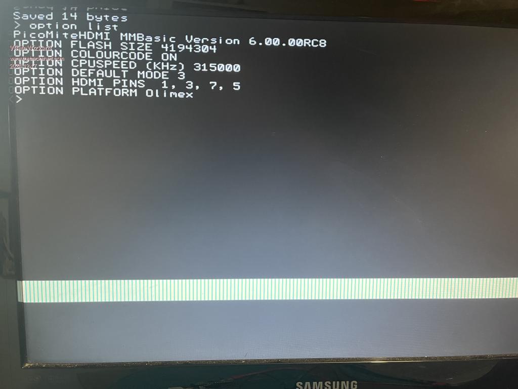

On exiting the editor (whether making changes to code or not, or by using F1, F2 , Esc or Ctrl-C) I get the following appear near the bottom of the screen all the way across.

  Quote  On exiting the editor (whether making changes to code or not, or by using F1, F2 , Esc or Ctrl-C) I get the following appear near the bottom of the screen all the way across.
Replicate on 6.00.01RC8 and I'll have a look
Posts: 2994
Posted: 09:46am 17 Dec 2024
(the issue on exiting the EDITOR shown in the screenshot in the above post seems to be when OPTIONs RESOLUTION = 640 and MODE = 3. On using other 'random' settings it works ok)

  Quote  (the issue on exiting the EDITOR shown in the screenshot in the above post seems to be when OPTIONs RESOLUTION = 640 and MODE = 3. On using other 'random' settings it works ok)
The issue is that you are using out-of-date firmware based on your screenshot 6.00.00RC8 NOT 6.00.01RC8
