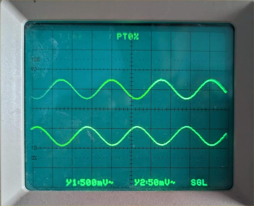

I've just updated B34 as follows:
LIBRARY LIST ALL implemented
Support for mono output in PLAY SOUND
PLAY SOUND chan, M, waveform, freq [,vol]
When M is set the right channel is set to to be the invert of the left
See the previous page for all the details of other changes

Posts: 12058
Posted: 11:18am 03 Apr 2023
No:
The two channels are running as normal just 180 degrees out of phase
Note on my VGA board design I am using GP22 and GP23 for audio (+ GP24,gp29 if DAC)

Posts: 12058
Posted: 03:37pm 03 Apr 2023
I can fix PLAY TONE - you will just use a negative frequency for the right channel. This will be in the first release candidate
e.g. PLAY TONE 400,-400
This will only work when the audio is stopped as subsequent PLAY TONE commands when a tone is active maintain the phase position to  avoid pops
