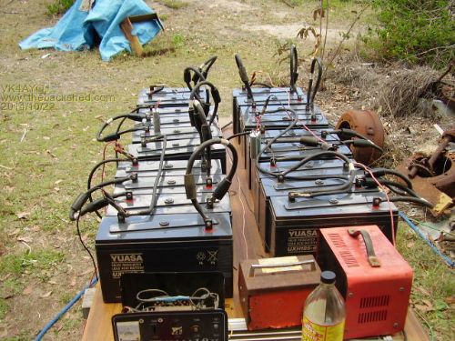

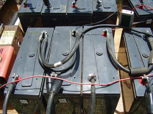

This is the collection of batteries that I think I can save there is 24 of them connected in series parallel for 24 volt nominal.

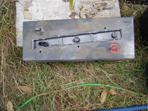

This is the valve chamber on the battery that I chiseled off to see if I could do anything with them.

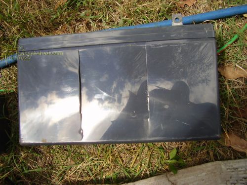

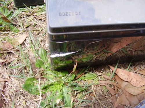

Here is the burst case where the sulphation built up on the end of the plates, this cell was still working with residual moisture in the middle of the plate pack but was not salvageable.
Looking from the side of the battery you can see the split case where the sulphation had built up.
If you look closley you can see the 3/16" holes I drilled through the top pf the case to get water into the cell packs that had not ruptured.
