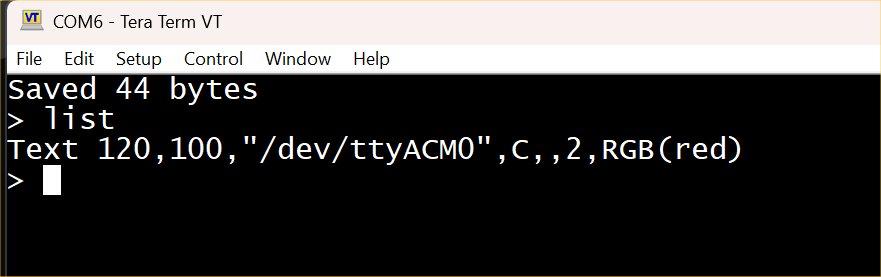

Fails. You cannot use "/" in a string anymore in a TEXT statement.
This seems wrong.
P.S. I re-programmed the LCD for landscape (not rlandscape), since (in my laptop) the USB ports are at the right side, and then all GEEK text is upside down.
Edited 2024-12-16 19:42 by Volhout

  Quote  Fails. You cannot use "/" in a string anymore in a TEXT statement.
This seems wrong.
I can
Edited 2024-12-16 19:49 by matherp

Peter,
This is strange. When I run the program it errors.
When I manually replace the first "/" with a "/" (built-in editor, replace it) it runs fine. When I save the changed program , and run it, it fails again.
As if running from the editor is different than running from flash.
Same happens when I run from flash slot.
[4] Text 120,100,"/dev/ttyACM0",C,,2,RGB(red)
Error : Syntax
Edited 2024-12-16 20:01 by Volhout
