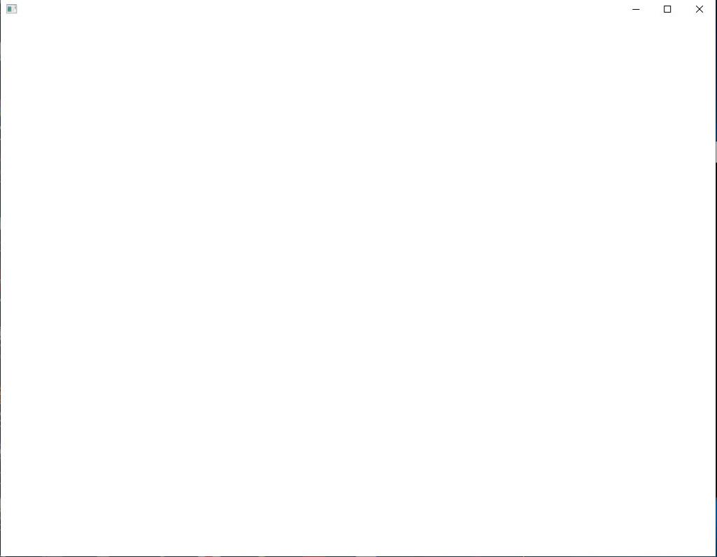

With any version of MMBasic I got blank window which dissapeared in about 15 seconds.
Windows 10 x64

Posted: 01:51pm 15 Apr 2022
  Kabron said  With any version of MMBasic I got blank window which dissapeared in about 15 seconds.
Windows 10 x64
Observed on two PC
Last working version: 5.07.03pa12
Edited 2022-04-15 23:53 by Kabron

Is this just the first time you run it or every time?  My antivirus(Avast) software interrupts the first run but pops up a notice that it is scanning the entire run of the code. Then It continues.  Maybe your antivirus is doing the same thing but not notifying you about the run time scan like mine does.

  Quote  With any version of MMBasic I got blank window which dissapeared in about 15 seconds.
Windows 10 x64
See page 8 of this thread and try launching from a DOS box with
MMBASIC 0

Posted: 07:07am 16 Apr 2022
MMBASIC 0
This works,
but COPY/PASTE not work in console window.
