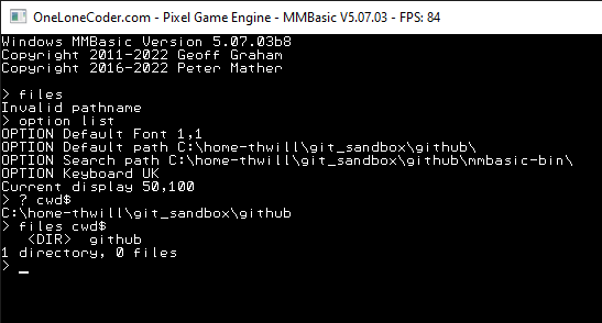

The last two versions posted seem to be have a significant regression, both displaying this behaviour:
Observe the misbehaviour of the initial FILES command.
Edited 2022-04-06 05:40 by thwill
Posts: 12040
Posted: 09:42pm 05 Apr 2022
Oops - got true and false the wrong way round
MMBasic.zip

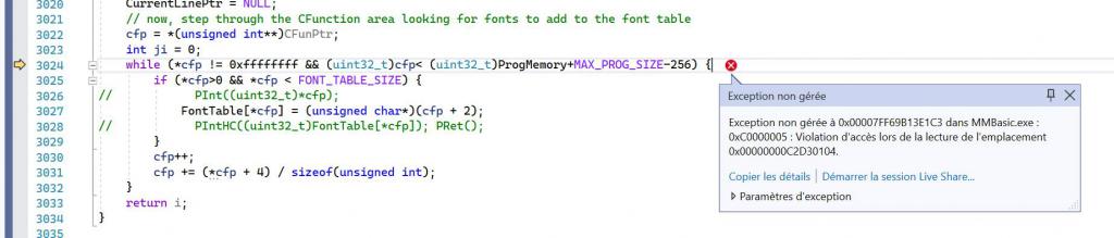

Posted: 09:35am 06 Apr 2022
Hello Peter
I just try to compile your latest code and get this error.
Is it something to set in the parameters to made it work ?
Here i am in debug mode , but when i go for 'Release x64' it compile but mmbasic start and after 2sec or so , the window disappear

Posts: 12040
Posted: 09:42am 06 Apr 2022
You should be compiling in release x86. It won't work in debug or 64-bit

Posts: 4405
Posted: 10:12am 06 Apr 2022
  matherp said  Oops - got true and false the wrong way round
MMBasic.zip
Working again thanks, and I can confirm that the Str$() bug is fixed.

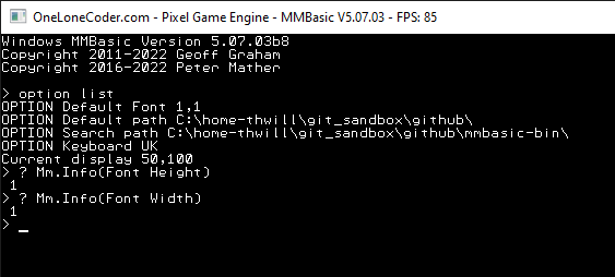

Posts: 4405
Posted: 11:03am 06 Apr 2022
Hi Peter,
What am I failing to understand?
Posts: 4405
Posted: 11:09am 06 Apr 2022
  thwill said  What am I failing to understand?
That there is no space in FontHeight and FontWidth and no error handling to catch it if you use one .
Posts: 12040
Posted: 11:54am 06 Apr 2022
  Quote  and no error handling to catch it if you use one
There are hundreds (thousands ?) of places in MMbasic where additional characters in commands/functions are not trapped. To do so would increase code size and slow performance. The code with the space is returning the current font. I'm not going to change this
Try
ON ERROR IGNORE TOM
On all versions
Edited 2022-04-06 21:58 by matherp

darthvader
Joined: 31/01/2020
Posts: 101
Posted: 12:12pm 06 Apr 2022
  matherp said  You should be compiling in release x86. It won't work in debug or 64-bit
Thank you Peter , now it compile well
Cheers.
