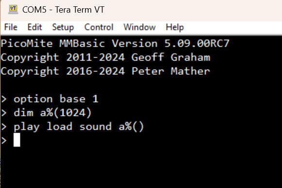

  Quote  A very minor issue, when using
Option Base 1
Can't replicate
Posts: 3414
Posted: 08:15am 27 Jul 2024
Ok, that has me stumped. At the command line I can't enter Option Base 1 so I put your lines in a program and it does not produce an error. Yet my program wouldn't run with Base 1

Re Option Base 1, couldn't find RC7 so loaded latest version of RC5 and it works.
Found another odd thing, Play STOP is quite temperamental.
When sounds are loaded, played and stopped in a loop (in a program) eventually Play STOP causes an error.
[25] Play STOP
Error : Invalid character: 0
Also at the command line characters after it or a space before it cause an error.
> Play LOAD SOUND PLS02() : Play SOUND 3, B, U, 440, 25
> Play STOP 'error if anything after it, or a space before it
Error : Unknown command
>  Play STOP
Edit.
Only happens with a loaded sound, pre defined Q, W, S & T all ok.
Edited 2024-07-27 23:23 by phil99
Footnote added 2024-07-28 08:30 by phil99
The error does not occur if the loaded array is empty.
Footnote added 2024-07-28 09:08 by phil99
Filling the array directly also does not result in an error.
for n=0 to 1023 : a%(n)=n*16 : next
is ok
There must be something wrong with my program, but can't see what.
