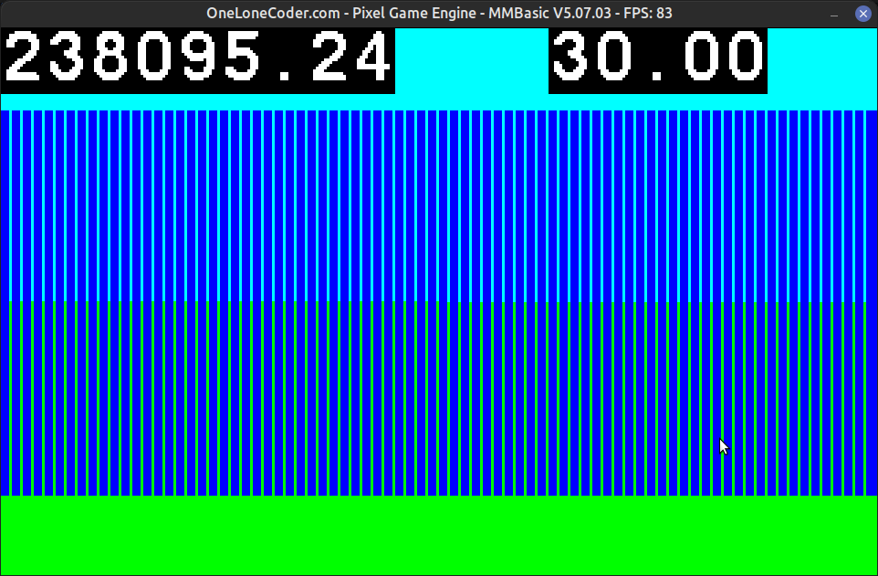

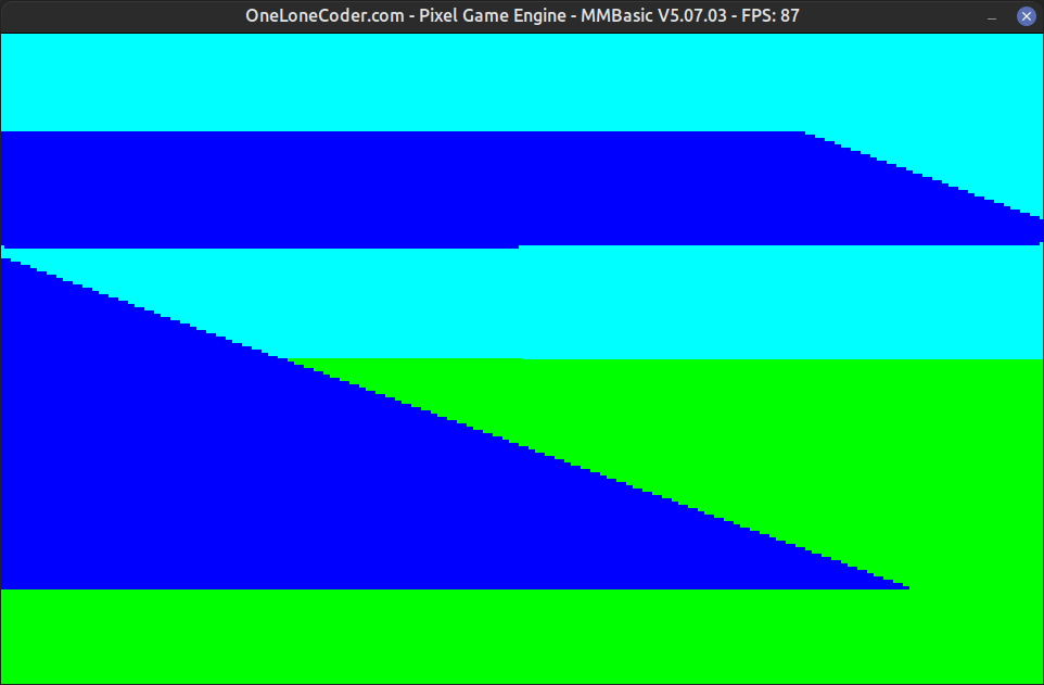

Hey Peter
I discover two issues running the MMBasic on wine (I don't know if they happen on Windows)
1) The page copy seems to do not respect the B argument. It is generating rendering artifacts.

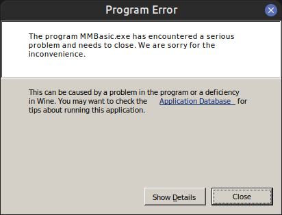

2) Sometimes the interpreter closes with the following page fault:
This is the backtrace:
Unhandled exception: page fault on read access to 0x00000014 in 32-bit code (0x00443f74).

Posts: 12040
Posted: 07:05am 04 Apr 2022
Page copy does not implement the "B" or "D" as there is no way of knowing the raster timing. Without the copy in a tight loop as you have it the copy is so fast that you shouldn't normally see any issues. I'm seeing 1700FPS on your test vs a screen refresh rate of 60Hz hence the artefacts (the framebuffer is getting written 28 times for each screen refresh)
Can't help with the wine issue. Looks like it might be running out of memory and unable to page - can you set the pagefile size in wine?

Posted: 09:29pm 04 Apr 2022
  matherp said  Page copy does not implement the "B" or "D" as there is no way of knowing the raster timing. Without the copy in a tight loop as you have it the copy is so fast that you shouldn't normally see any issues. I'm seeing 1700FPS on your test vs a screen refresh rate of 60Hz hence the artefacts (the framebuffer is getting written 28 times for each screen refresh)
Thank you Peter
I updated the code to control the scene repaiting. The left counter is from the main loop and the right one is from the screen rendering.
I think it is using the pagefile size from Linux. I'm not sure. I will take a look.
