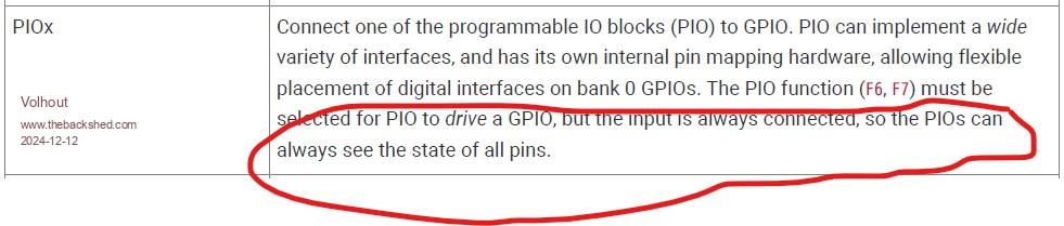

Posts: 12044
Posted: 09:59am 12 Dec 2024
When pins are set as outputs (e.g. PWM) the input capability is turned off. Therefore PIO can't read them (logically except for your demo purposes there is no real reason why you should be able to).
If you set your PIO to read pin A and PWM on pin B and connect a wire between A and B it should work if A is set as an input (not PIO). I will make a change so that A can be set as an input OR PIO.
Posts: 6192
Posted: 10:09am 12 Dec 2024
Peter,
If I connect GPx to a 3.3V power supply, regardless of what I do, PIO does not see a high level in 6.00.01b6. It is always 0.
Regardless if I set pin to PIO1,DIN or whatever. PIO is deaf.
About the capability of PIO to read pins when MMBasic drives them...
- this functionality existed in 5.09.00
- it does not exist anymore
- this feature is also used in the PIO chapter in the user manual (EXAMPLE PROGRAM 3). In case this functionality is lost, I need to carefully check and adapt that section before it is published.
Edited 2024-12-12 20:15 by Volhout

Posts: 6192
Posted: 11:32am 12 Dec 2024
  matherp said  The example gives the same issue. GP2 is an output so it isn't an input and can't be read.
This worked in 5.07,xx 5.08.00, 5.09.00, and not anymore. The RP2040 is capable. Something disables this function.
Maybe this is disabled in the new toolchain for compatibility to 2350.
I will ask Geoff remove the applicable section in the user manual for 6.00.01.
I will revert back to 5.09.00 since I need this function.
Thank you for your support. Sorry to be such a problem maker...
