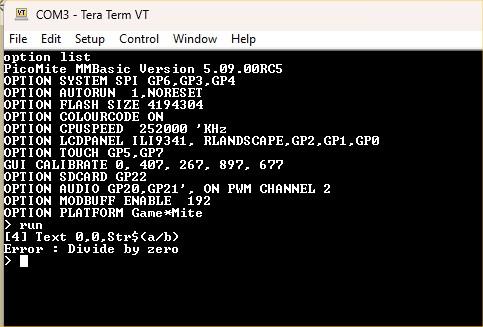

Hi Peter,
I have done some more testing:
The GEEK (PicoMite with SPI display) works correct.
The PicoMiteVGA works correct.
The Thermal Imager (ILI9341) does not show the problem, or it would have creashed during my development constantly.

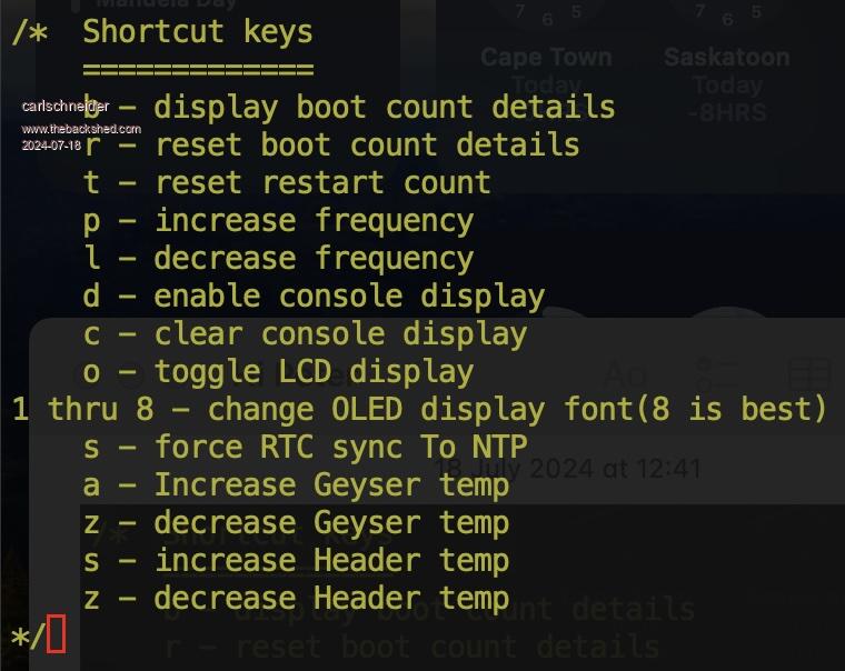

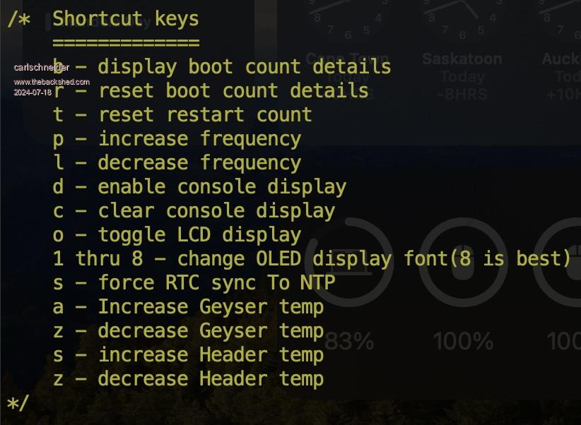

Another quirk I've noticed in the rem block is one comment which is tabbed keeps losing the leading tabs when saved.
Cheers Carl

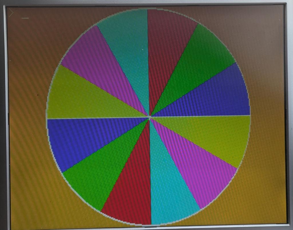

Prompted by a comment from Stanley, Ive added the map command and function to the PicoMiteVGA and PicoMiteVGAUSB based on the CMM2 functionality (see the CMM2 manual).
Load up the new firmware and run the following:
PicoMiteVGA.zip
' Set up an array to hold the colour mappings we are going to use
Dim integer cmap(6)
'Clear the screen
MODE 2
Map reset
CLS
'Set up 6 colours in the array
cmap(1)=RGB(red)
cmap(2)=RGB(green)
cmap(3)=RGB(blue)
cmap(4)=RGB(yellow)
cmap(5)=RGB(magenta)
cmap(6)=RGB(cyan)
' Do an initial update of the Colour map to set up our colours
domap
'Display an outer circle in white
Circle MM.HRes/2,MM.VRes/2,MM.VRes/2-1,0,,RGB(white),RGB(white)
' Now draw a simple colour pie chart using our new colours with the ARC command
Arc MM.HRes/2,MM.VRes/2,0,MM.VRes/2-3,0,30,Map(1)
Arc MM.HRes/2,MM.VRes/2,0,MM.VRes/2-3,30,60,Map(2)

Can you explain what the difference is between the Map(I) as function, and an array Map() in this application.?
Is the to avoid DIM ing an array Map(6), or using Map reset.?
Thanks for the explanation.
Edited 2024-07-25 05:53 by Volhout
stanleyella
Joined: 25/06/2022
Posts: 2807
Posted: 08:51pm 24 Jul 2024
I'm frustrated my pico vga is usb so can't try but I'll make a vga board later.
until I can try map, what's it do please?
stanleyella
Joined: 25/06/2022
Posts: 2807
stanleyella
Joined: 25/06/2022
Posts: 2807
oops
Edited 2024-07-25 06:53 by stanleyella
Posts: 12044
Posted: 09:59pm 24 Jul 2024
  Quote  Can you explain what the difference is between the Map(I) as function, and an array Map() in this application.?
The map( function returns a 24-bit RGB value that will pick up the slot that you have specified a colour for
so:
MAP(1)=rgb(brown)
map set
Will cause any "normally" blue pixels to turn brown. In order to then use a drawing command with the brown colour use the map(1) function as the colour
This should be obvious in the example. This is how the CMM2 does it using a H/W colour lookup table (CLUT) whereas the PicoMite does it in the VGA driver in S/W.
NB: this functionality is only available at CPU speeds of 252 and 378 MHz

  Stan said  I'm frustrated my pico vga is usb so can't try
  Peter said   Ive added the map command and function to the PicoMiteVGA and PicoMiteVGAUSB
