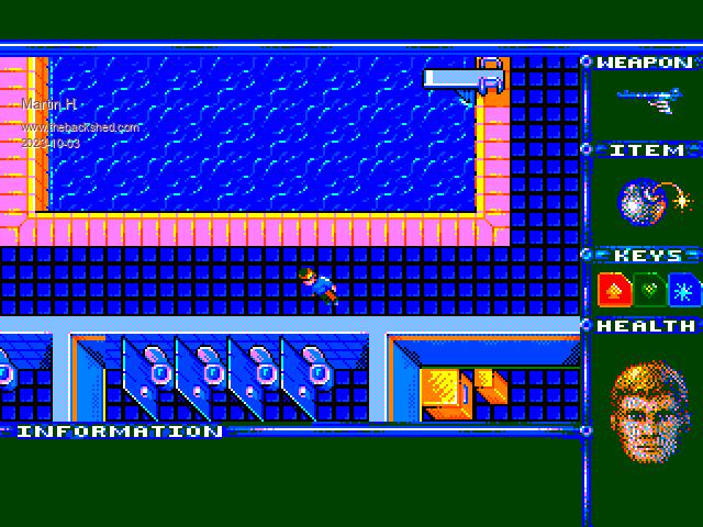

Good Morning Harm,
the Item and the Health Icons does not absolutely have to match into the 24x24 grid.
They have fixed Screenpositions at the Info Panel..
like this:
Tileset
Health ,Screenposition: 272,160
HL good to bad = 0 to 5
Tilesize: 48 x 52
Item/Weapon
ITM 0 & 1 Weapon, Screenposition: 272,36
ITM 2-5 Item, Screenposition: 272,80
Tilesize:48 x 24
Keys KEY:Tilesize: 16 x 16
Screenposition: 272,124 | 288,124 | 304,124

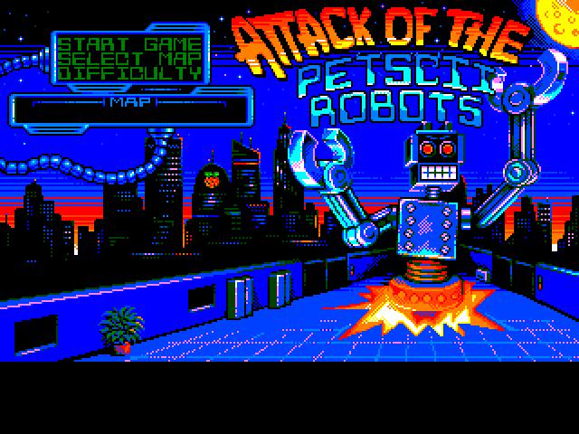

I've repainted the Items and Icons with DarkGreen BG Color and
refurbished the Intro Screen for better readability:
Here are the updated Files & the Font
Artwork Update.zip
Have Fun
 Mart!n

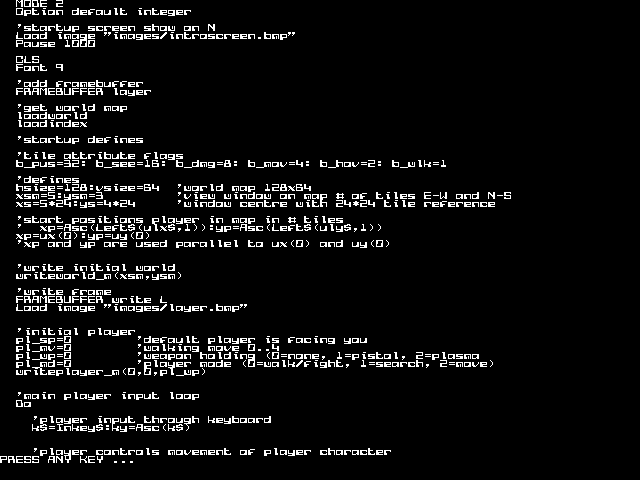

PS: Your Listing looks nicer with the PETSCII Font:
Edited 2023-10-04 22:03 by Martin H.

The listing with the game Font was a Joke
