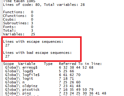

Posts: 6626
Posted: 08:17pm 18 Mar 2023
And the next MMEdit will include a list of escape sequences, both good and iffy in the variable report.
Just to make conversion easier.
Hans

Posts: 6626
Posted: 08:27pm 18 Mar 2023
  Hans said
Sorry if I missed it, but does that mean that we will no longer have CHR$()?
That really is a Basic language staple!
Don't worry, chr$() will still be there and needed. The escape sequence options are an addition, not a replacement.
