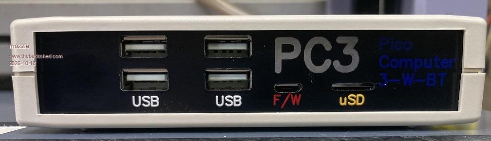

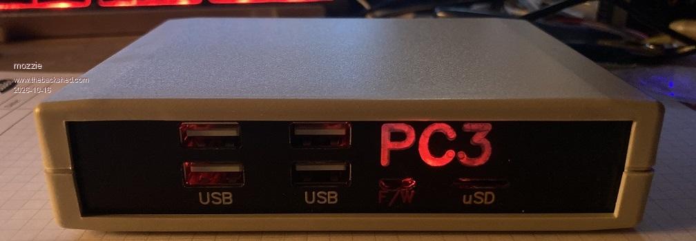

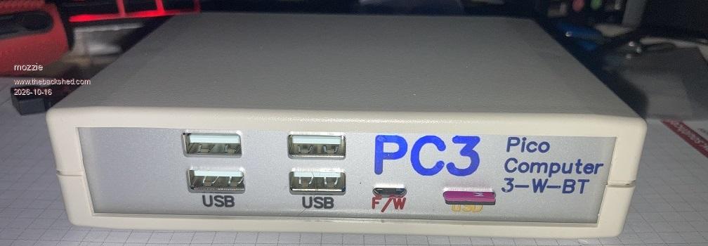

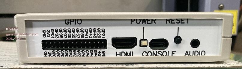

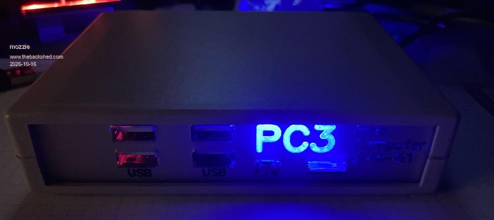

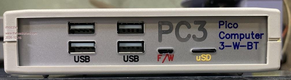

Having said that, whilst ordering engraving sheet for other projects this week I added some extra to finally make some fascias for the PC3 enclosure. After a bit of stuffing around in CAD and with the machine, I must admit I'm pretty stoked with the result
These are "reverse engraved", so the cut is from the back and can be filled with paint for colour or backlit with an LED.
Black on clear first try, needs adjusting:
Silver on Clear second try:
Hearbeat LED as backlight:
Blue LED as backlight in dark:
Blue LED as backlight in light:
Rear Panel, normal front engraved, needs more work:
The font is Simplex and my graphic design skills are terrible, but the reverse engrave technique has always looked good to my mind.

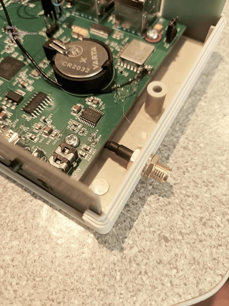

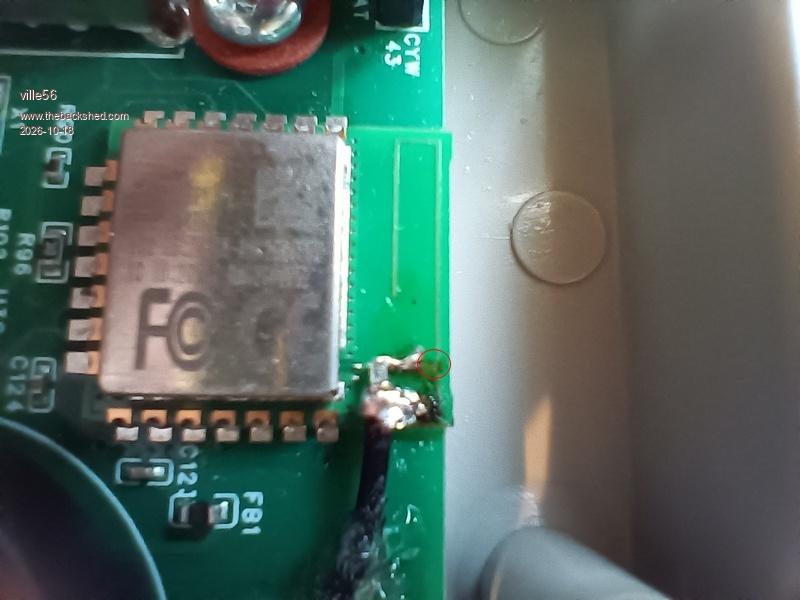

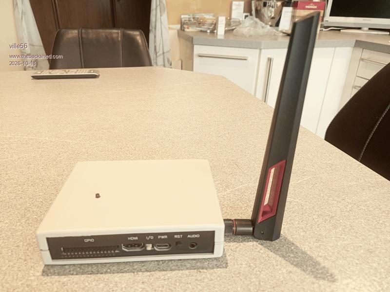

As I do have problems with WiFi coverage, despite a router and 3 repeaters, I've done a mod on the WiFi module to add an external antenna. The mod gives me about 20 - 30 dB gain on the signal (according to the rssi values) and now covers the area I need.
The mod itself was technically easy, just cutting the copper track for the resonant circuit on the module, scraping off the solder mask from the ground and antenna tracks and soldering the coax cable. The point for the cut is between the coax inner conductor solder point and the rightmost PCB track on the first picture (at the red circle). This leaves the antenna connection comeing from under the metal shield free to solder.
It's a bit tiny for sure and my eyes are simply not the best anymore after 70 years of constant usage ... but it worked on the first approach.
The connector is a reverse SMA as all the WiFi antennas I know do use that. The cable had a tiny connector on the other side which I just did cut off. The length of the cable is intentionally for being able to take the PCB out of the case easily. The loss of another 2 or 3 dB because of the additional length should not matter. The strain reliefe is high tech: hotmelt adhesive, but it is important as the coax is really thin stuff as are the PCB tracks.
