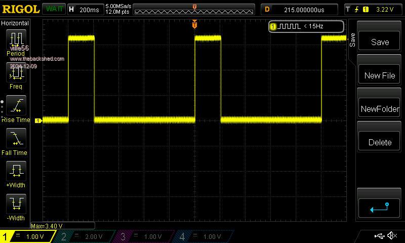

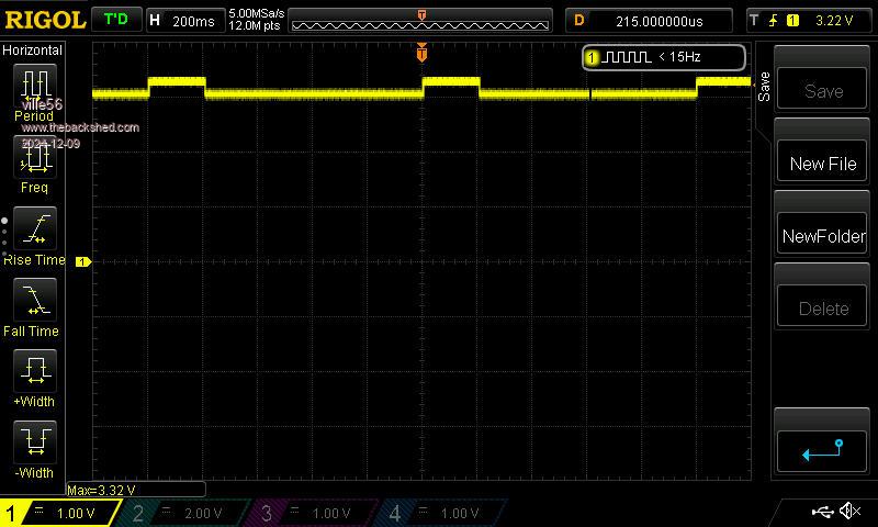

2 scope images:
1) signal at the DS18B20 without pullup resistor (data are at the low/high transition but resolution is too low to see them)
2) same signal with pullup 4k7 attached
my conclusion: the pico does not properly pull the pin to low with 4k7 pullup to start the conversion because the output is not correctly set since at least V6.00.00 RC17.

It looks like that. Perhaps the output wasn't set to low before the in/out mode switching? That would almost certainly be in the firmware.

To me it looks like it is switching between weak pullup and weak pulldown.
Where it should be between weak pullup and output low.
Maybe the wrong bit is set in the data direction register for the TEMPR driver.
This could be a result of Peters experiments with the 2350 GPIO problem.
