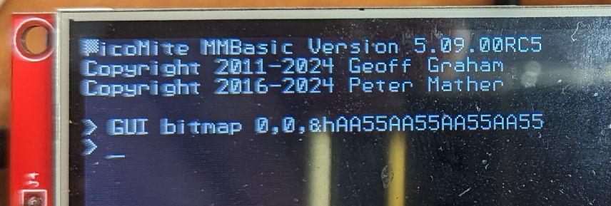

Posted: 03:10am 11 Jul 2024
  matherp said  Works for me
hi!
can you share with me the pins connection to this display and the OPTION's that you use to make this lcd works?
I have the same lcd 3.5" TFT SPI 480x320 V1.0, but i cant make it work.
Thanks!!!

The position of "J4" above the SD connector in the pic suggests an ILI9341 320x240 but
  Quote  lcd 3.5" TFT SPI 480x320 V1.0
indicates an ILI9488. It may have "J2" below the SD connector.
  manual said  OPTION LCDPANEL ILI9488, OR, DC, RESET, CS [,BACKLIGHTPIN]
Initialises a TFT display using the ILI9488 controller. This supports 480 * 320 resolution.
Note that this controller has an issue with the SDO (MISO) pin which interferes with the touch controller.
For this display to work the SDO pin must not be connected directly to the Pico MISO, unless isolating components are added. (search forum for ILI9488).
Add a 1N4004 (or any 1N400x) or 1N5819 diode**, anode to LCD_SDO cathode to Pico MISO and a 1.8kΩ to 10kΩ resistor from LCD_CS to Pico MISO. As T_DO connects to Pico MISO these can be added to the top of the connector on the display. If using a PCB that has LCD_SDO connected to MISO it will be necessary snip off the LCD_SDO pin.
As in this photo  and this
And you could configure it like this (adapted from the manual p50):-
To match the above connections the following configuration commands should be entered, one by one at the command prompt:
OPTION SYSTEM SPI GP18, GP19, GP16
OPTION SDCARD GP22
OPTION LCDPANEL ILI9488, L, GP15, GP14, GP13
OPTION TOUCH GP12, GP11
These commands will be remembered and automatically applied on power up. Note that after each command is
entered the PicoMite will restart, and the USB connection will be lost and must be reconnected.
Edit ** Any diode with at least 22pF junction capacitance will work. If using one with a very low junction capacitance such aa 1N914 or 1N4148 add a parallel capacitor of 22pF to 100pF.
