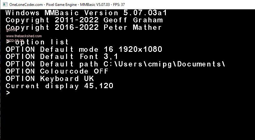

Is there a MMB4W mode that matches the ILI9488's 480x320? I don't see it in the CMM2 manual, but seem to recall that some modes have been added to MMB4W.
I see that mode 7 matches the ILI9341's 320x240. Being able to exactly match an LCD resolution makes it easier to develop a graphical interface with MMB4W which can seamlessly be moved to the PicoMite.
Posts: 12040
Posted: 02:20pm 18 Mar 2022
  Quote  Is there a MMB4W mode that matches the ILI9488's 480x320?
Here you go - mode 20

Posts: 3885
Posted: 08:48pm 18 Mar 2022
  matherp said  Here you go - mode 20
Thank you. I had tried, though I feared not rigorously, to make the display somewhat independent of the resolution, and mode 20, 480x320, worked perfectly with no other changes for the program from here (which used mode 13, 400x300).

goc30
Joined: 12/04/2017
Posts: 435
Posted: 10:42am 20 Mar 2022
  matherp said  You still have only 1080 high and I'm not spending time on this, no way to replicate dual screens and the vagaries of your drivers  - sorry
Try mode 19 which is optimised for 1080p monitors
first, can-you explaine this screen_capture
I am in 1920x1080 res and you can see that first line is visble, not under mmb4w window's top border
If the A1 version works and after that it no longer works, it means that you have modified something that worked well for something that has a malfunction.
Second, in mode 19 , I lost 80 pixels why?? have you tested a resolution of 1920 x 1079 ??
Third, If I put my second screen after bottom of first screen (posy1=1080, posy2=2159), mode 16 work correctly, but bottom bord of mmb4w's window is in second screen (y1=0 and y2=1080) why y2 pos is not 1079 ??
in all app working under MSWindow (from 3.1 to 11), windo's borders are into screen resolution, not out of, except mmb4w
