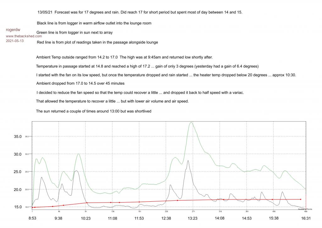

Forecast for today was for 17 and raining, and that is spot on.
There was a bit of sun while I was doing the school run but by the time I got back it was getting grey.
The air outlet was up around 27, but with the rain, then 24, 20, 18  ...
I decided to slow the motor more from its already low setting, so used the variac on 140 volts.
That's allowed the output to hang between 20 and 27 degrees, but obviously with a much slower airflow.
Just for some context  ...  on the normal low speed at 42 watts  ...  airflow is 3.0 cubic meters per minute and velocity 3.15 meters per second.
Run at 140 volts  ...  airflow is 1.5 cubic meters per minute and velocity 1.46 m/s  ...  so driven with 140 volts looks pretty much half speed for the fan.
It is so quiet now that even outside you can barely hear it  ...  and inside you only hear a bit of wind noise as it goes in the duct.
Of course, todays results are going to be nothing like yesterdays  ...  so will be interesting to look at the temps tonight.
Certainly it looks like controlling the fan speed in relation to the outside light will be the best way to keep the output temperature from dropping too low.
I did a power test mid morning on the pv panel and was getting 9.16 watts = 18.32 watts for two.
At 1pm it was 87 watts x 2 = 174 watts. Yesterday it was 289 watts.
Cheers,  Roger

Well I'm back with todays update.
A bit disappointing though definitely not unexpected considering the lower temperature and the rain  ...  along will full cloud most of the day.
Probably stating the obvious but it's not the outside temperature so much that affects the performance  ...  rather the amount of sunlight available.
Once the sun appears between the clouds, temperatures rise quickly  ...  but go away just as quick.
Tomorrows forecast is for the same, 17 and rain  ...  but the next few days are 17 and 18  ...  but with a bit of sun. That should supply results similar to yesterday so am looking forward to that.
In the chart below you can see the result of the lower fan speed from about 11:30  ...  where there is a higher difference between the outside sun temperature and the output from the heater.
I'm guessing I can put that down to the lower airspeed and volume, allowing the air more time inside the tubes gaining more heat.
During the jump in output around 13:00 from ~27 up to ~34 there was only a one degree rise in the ambient temperature. No question it was just the sunlight through the clouds that had the affect.
Edit: The software has swapped the black and green line colours and I didn't realise it  ...  so it is the green line that shows the temperature of the hot outlet  ...  and the black line shows temp in the sun next to the array.
Edited 2021-05-14 15:53 by rogerdw
Cheers,  Roger

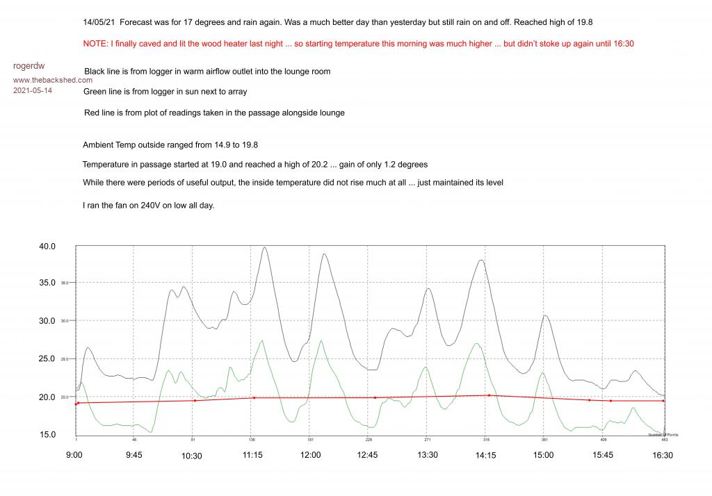

Update for Friday 14/05/21
First off, I weakened and lit the fire last night.
Made a big difference and the starting temp in the passage this morning was 19.0 (yesterday was 14.8)
Forecast was for 17 and rain so I expected similar results to yesterday  ...  but there was less rain and a few more periods of sunshine.
Coz there was a little sunshine when I switched on the fan this morning, I went back to 240 volts and used the low setting.
The graphs show the story.
Cheers,  Roger
Davo99
Joined: 03/06/2019
Posts: 1586
Posted: 09:55am 14 May 2021
I fired up the Diesel heater!  :0)
The effect of the sun on the tubes is exponential.
The more sun they get, the greater the temp difference they produce. Does not seem linear.
If the fan was faster than yesterday, the temps also seemed higher so that is good.
Maintaing temp isn't a bad thing.  The fan heater has been doing that well here and keeping it around 19-20. It hasn't had to offset real cold yet.
As long as it does not get below 19-20,I'm happy.
Supposed to get colder here over the next few days, 1o on Sunday, 3 for the rest of the week but also supposed to be sunny.
Hopefully the sun will be out for you too.
rogerdw
Joined: 22/10/2019
Posts: 957
Posted: 12:35pm 14 May 2021
  Davo99 said  I fired up the Diesel heater!  :0)
Yes, I saw that, great news. I'll come over and ask some questions in your thread.
  Quote  The effect of the sun on the tubes is exponential.
Yeah, almost seems like an amplifier.
And if the fan is off, they act like a capacitor or battery  ...  building up and storing heat energy. Then take a number of minutes to discharge once the fan is turned on.
  Quote  If the fan was faster than yesterday, the temps also seemed higher so that is good.
Yes, it was quite noticeable that the sun was out a lot more than yesterday, even though the forecast was much the same as the day before.
Certainly looks like varying the fan speed can control the temperature  ...  but it's only the sunlight that can increase the power out.
If the assy was to stay on the ground, I wonder if a large parabolic reflector wing could be raised to reflect light back across the surface of the tubes from either side  ...  oposite the direction of the sun.
On the west side in the morning and the east side in the afternoon  ...  and both sides in the middle of the day.
  Quote  The fan heater has been doing that well here and keeping it around 19-20. It hasn't had to offset real cold yet.
That's good to hear. I've never really taken note of actual temperatures until the last week  ...  now I'm getting out of bed in the morning to check the thermometer  ...  walking around with a clipboard noting down the time and temps from a whole swag of thermometers.
Could certainly feel the difference between 14.8 yesterday morning and 19.0 this morning  ...  because of the wood fire in this case.
  Quote  Supposed to get colder here over the next few days, 1o on Sunday, 3 for the rest of the week but also supposed to be sunny.
Haha, I never used to pay attention  ...  but ours is supposed to be 17, 18, 18, 19 over the next four days, so looking forward to that to see more output (I hope).
Cheers,  Roger

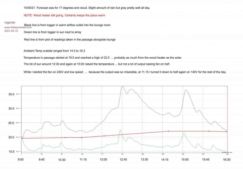

Posted: 07:50am 15 May 2021
Well today's results were pretty much as expected due to the low temp and clouds virtually all day. Only a couple bursts of sun in the afternoon.
Once again you can see the substantial difference between the temperature outside in the sun  ...  and the heat coming out of the outlet tube. A peak of 22.5 equates to a top of about 37.5  ...  but again, because the fan is on slow the overall power is not great.
Tomorrow's forecast is for 18 and bit of sun with clouds...  no it's not!!! They've changed the forecast to cloudy again.
Haha, never cared before, now I'm ticked off with poor weather.
Cheers,  Roger

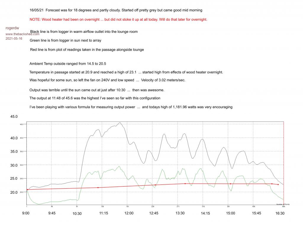

Posted: 08:42am 16 May 2021
At last!!!  Today was pretty respectable in regards to heat output. The highest I've seen so far.
Had a high of 45.6 out of the collector late morning.
I had also been looking for the formula for determining power output in watts, from air velocity, difference in temperature between inlet and output etc  ...
...  but most that I had seen were using imperial units and farenheit  ...  and it was a pain trying to convert everything without introducing mistakes.
I finally found one that seems to make sense  ...
Airflow in meters per sec x
Outlet Cross Section Area (in sq meters) x
Specific heat of air (~1000 J/kg-C) x
(Outlet temperature minus Inlet temp)
= Output Power in Watts
Assuming this formula is legit  ...
...  then the best I saw today was 1,181.96 Watts.
Not sure if this is good or not really. Have watched lots of videos on flat plate solar collectors now  ...  and when they do quote figures, they are quite a lot higher than mine  ...
...  and they are usually for simple boxes with either soft drink cans with the ends opened up and in stacks  ...  or with black metal flyscreen material draped inside to act as the collector.
I don't know if they are not being honest, being careless with their measurements  ...  or whether those collectors really are a better method than evacuated tubes.
If it is the latter  ...  then a big panel with flyscreen stretched across the works has to be so much simpler that several sets of evacuated tubes all assembled and hoisted into place. Mmmm!!
Cheers,  Roger
InPhase
Joined: 15/12/2020
Posts: 189
Posted: 12:29pm 16 May 2021
  rogerdw said  At last!!!  Today was pretty respectable in regards to heat output. The highest I've seen so far.
The dimensions of that formula don't add up to watts. Watts are kg*m^2/s^3. What you have there comes out to m^5/s^3...
Davo99
Joined: 03/06/2019
Posts: 1586
Posted: 12:40pm 16 May 2021
I can think of one very easy way to sway the numbers legitimately... Latitude.
People In brisvegas could probably do 50% better than you are getting straight up with the exact same equipment.
I would also tend to think that the influence of snow on the ground could help Tubes. I know with a bit of smarts it can help panels do well OVER rated output.
Yet another question that immediately comes to mind is the volts/ kwh equation.
Maybe the flat plates can outdo the PEAK output of a tube collector BUT, what is the TOTAL output of each one over the course of the day?
I can see where a flat plate could outdo the tubes at Midday but what about the 4 hours before and after? As I see it, sun angle is going to be far less important to a tube than a flat plate unless the flat plate is tracking... which would be a huge pain in the arse and an expensive pain in the hip pocket.
  Quote  ...  and they are usually for simple boxes with either soft drink cans with the ends opened up and in stacks  ...  or with black metal flyscreen material draped inside to act as the collector.
My thought here is what I have harped on all along :0) Surface area.
The way I see it, the tubes are good at not loosing heat but still need surface area to gather it. I also see they are probably getting 50-60% Coverage of the area as you have set them up.
The enclosed designs would also probably be good at minimising heat loss and if they can say get another 30% surface area with only 10 % loss....
The other thing is if you are comparing the same collector area. I'm not sure if you are going by total width or width of tubes or even any similar measurement. I doubt you have the same dimensions as the flat collectors so maybe you have to work it out on a M2 Comparison to see how you are going?
I have found repeatedly many do exaggerate performance rather than what I perceive you do ( as do I) and tend to err on the side of understating rather than overstating. I have also found that some people don't deliberately lie but they do tend to forget or overlook outside influences  that either add or subtract from the real numbers and it always tends to be in their favour.
With my vast and total non experience with these things, I find it a bit hard to imagine that these DIY boxes could outdo something like an evac tube when correctly  compared. There is some science and precision put into those tubes, far more than I would perceive the same level COULD be put into home made devices.
The one thing I do know is real efficiency tends to suck. You may think you are getting a good result but good efficiency is a very evasive thing.
I remember making Biodiesel and heating oil.  I made a contraption that boiled it in 1/3rd of the time we were doing it before.  My very learned friend sat down and calculated we increased efficiency from about 4% to about 14. Made a difference but still woeful in the real numbers.
Anything home built tends to have a lot lower efficiency that what people think and if you look at the modern car engine with the endless Billions that have been sunk into them over 100 years, they still suck in efficiency as well even though they have improved dramatically.
I don't see where your design could be loosing a lot of heat so would tend to think That there are some apples coming into the equation somewhere along the counting of oranges.
Again, double your collectors and you are getting 2.2 KW, that's going to make a difference. What you need might be different but I would suggest it's a brute force  game and there is little to be gained in trying to increase efficiency, it's sq M that's going to be the factor.
Again, whether that should be calculated as overall width of the equipment or measured as combined tube width I have no clue but, either way I would suggest you need to be sure you are comparing the same thing even after all the other pervasive errors may have leaked in.
  Quote  If it is the latter  ...  then a big panel with flyscreen stretched across the works has to be so much simpler that several sets of evacuated tubes all assembled and hoisted into place. Mmmm!!
I was thinking of solar panels.  Rather than duct the air around the back of the panel, would be easier just to insulate it to stop the heat loss. Bit of insulation batt held in by some plywood and just have the air blowing over the top.
Yes, the panel -MAY- run hotter and loose some electrical efficiency but if there is enough air blowing over the top, what is the loss through increased temp going to be and is it worth the extra effort and cost in chasing it?
Having measured panel temp laying flat on my corrugated roof and that of panels  with a meter or more free air space behind them and the close ( 1 o or so ) difference , I'd bet a  lot of money on the answer being NO.
Would be damned interesting to build one of these collectors out of a panel and test the combined output that's for sure.
rogerdw
Joined: 22/10/2019
Posts: 957
Posted: 02:44pm 16 May 2021
  Davo99 said  I can think of one very easy way to sway the numbers legitimately... Latitude.
The thought did cross my mind today about all the snow and the extra reflection, though I never considered the latitude. That could make a big difference.
  Quote  Maybe the flat plates can outdo the PEAK output of a tube collector BUT, what is the TOTAL output of each one over the course of the day?
Yeah, good point.
I have no idea how to do it, but I probably could feed my datalogger data into a program where it spits out the instantaneous power level for each minute of the day  ...  at least when it's producing  ...  and put a figure on it.
I really need a couple extra loggers to monitor other variables to see if I can see anything worthwhile. Even just having one on the inlet manifold the whole time could be interesting.
  Quote  My thought here is what I have harped on all along :0) Surface area.
Yeah I'm convinced of that now, and some of their panels are quite large  ...  so their actual total area is going to be much, much bigger than mine.
I think it was just a couple of the can ones that overall were not that big  ...  and yet their figures looked really good  ...  and that guy was very careful with his figures and explained very well what he came up with.

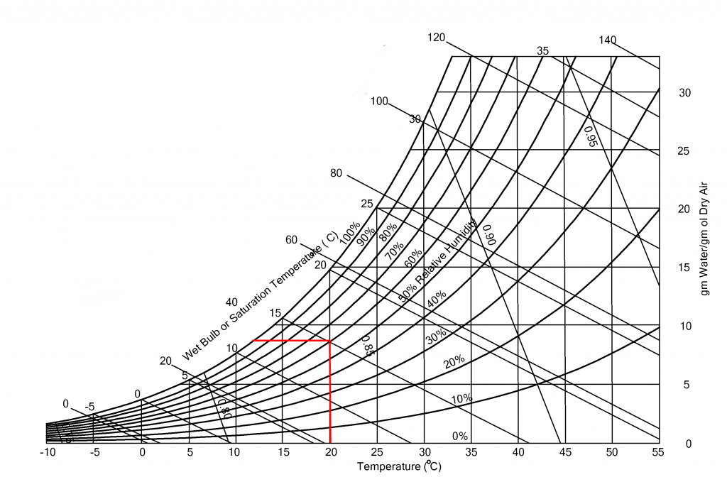

Posted: 05:03am 17 May 2021
The warmer the air, the more moisture it COULD hold.
So if you want to dry something out, you heat up the air.
If you cool the air, the same amount of moisture is still there, but it approaches 100% humidity at some lower temperature, and the moisture condenses out as dew or as rain.
So if you heat the air in a cold room, clammy damp cold, then becomes dry and warm, even though the same amount moisture content is still in the air.
The heating and air conditioning guys are really into this stuff, as are meteorologists.
Here is a psychometric chart that ties it all together:
At the top is the 100% humidity, or wet bulb temperature, or dew point.
Along the bottom (dry bulb) temperature.
Vertical scale is the actual physical water content.
Curved lines are RELATIVE humidity.
The red lines show "typical" ambient conditions, 20 Celsius and 60% humidity.
If the room cools to 12 Celsius humidity reaches 100% and everything feels very cold and damp.
If you fire up your oil heater to reach a room temperature of 35 Celsius, humidity falls to about 25% which is very dry.
