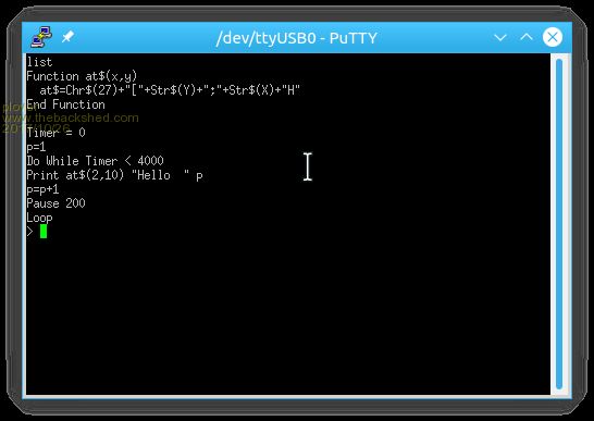

palcal
I am not clear on where you are at right now. You might find my journey to enlightenment of some use.
You are using mint but I think even so you may be able to take advantage of my stumbling about with pclinuxos and wine trying to figure out the details of getting connected to MME and mites using linux.
http://www.thebackshed.com/forum/forum_posts.asp?TID=9723&PN=1&TPN=6
I have already forgotten most in a few weeks being sidetracked (learning laptop motherboards repair amongst others)
I wrote a list of things to follow for my record, as I knew I would need when get back to my own topic in the link above.
Added later
Got a bit concerned when reading my own writing, had trouble recognising the steps. I just made a quic re-run connecting to putty only (MME not opened yet)
[gert@KDE5-os2 ~]$ tail -f /var/log/messages
Oct 26 11:20:53 KDE5-os2 klogd: usb 5-1: New USB device found, idVendor=0403, idProduct=6015
Oct 26 11:20:53 KDE5-os2 klogd: usb 5-1: New USB device strings: Mfr=1, Product=2, SerialNumber=3
Oct 26 11:20:53 KDE5-os2 klogd: usb 5-1: Product: FT231X USB UART
Oct 26 11:20:53 KDE5-os2 klogd: usb 5-1: Manufacturer: FTDI
Oct 26 11:20:53 KDE5-os2 klogd: usb 5-1: SerialNumber: DA01IIIT
Oct 26 11:20:53 KDE5-os2 klogd: ftdi_sio 5-1:1.0: FTDI USB Serial Device converter detected
Oct 26 11:20:53 KDE5-os2 klogd: usb 5-1: Detected FT-X
Oct 26 11:20:53 KDE5-os2 klogd: usb 5-1: FTDI USB Serial Device converter now attached to ttyUSB0
Oct 26 11:20:53 KDE5-os2 mtp-probe: checking bus 5, device 3: "/sys/devices/pci0000:00/0000:00:1d.3/usb5/5-1"
Oct 26 11:20:53 KDE5-os2 mtp-probe: bus: 5, device: 3 was not an MTP device
gert@KDE5-os2 ~]$ ls -l /home/gert/.wine/dosdevices/com*
lrwxrwxrwx 1 gert gert 10 Oct 26 10:43 /home/gert/.wine/dosdevices/com1 -> /dev/ttyS0
lrwxrwxrwx 1 gert gert 10 Oct 26 10:43 /home/gert/.wine/dosdevices/com2 -> /dev/ttyS1
lrwxrwxrwx 1 gert gert 12 Aug 5 12:03 /home/gert/.wine/dosdevices/com5 -> /dev/ttyUSB0
[gert@KDE5-os2 ~]$
The first section shows my Serial Device details
The second shows what comport is needed when Putty is opened
This looks simple but plenty of steps to get stuck with when you a learning. I repeated above because I have updated the linux system a couple of times since I last did any work in my thread. Edited by plover 2017-10-27
