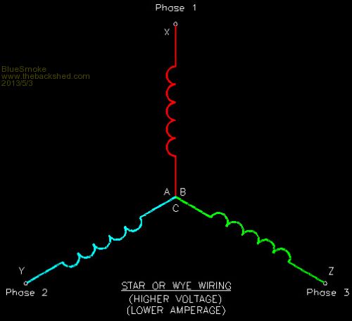

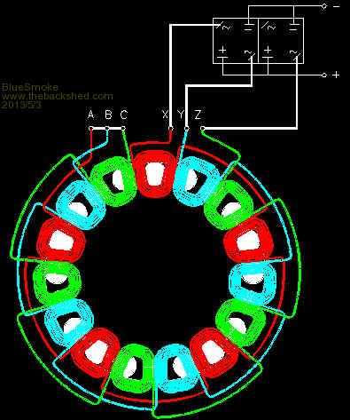

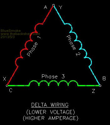

Below are diagrams of my stator wiring. (Star, Star Wiring Connections, Delta and Delta Wiring Connections)
I will have 6 connection points, each an end of 5 coils in series, per phase.
This will allow me to set up as Star or Delta configuration and test each phase for resistance, voltage amps etc.
Star - Phase1, Phase2 and Phase3 w/Connection Points
Delta - Phase1, Phase2 and Phase3 w/Connection Points

Connecting the windings in closed loop delta will certainly work, but it is less than ideal.
One way to run in delta without the problems of harmonic circulating currents would be to bring out all six wires without any interconnections on the ac side.
Then connect each winding to it's own individual bridge rectifier.
You then parallel up the three bridge rectifier outputs on the dc side.
This works exactly like the traditional delta connection, and it gives the same output voltage and current. Only difference is, each winding works quite independently on the ac side, and any waveform distortion no longer matters.

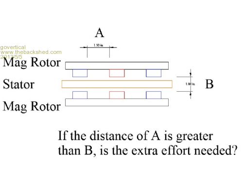

Hi, does having the magnets so tightly packed together cause a problem? Would it decrease the lines of flux passing through the coils? Edited by govertical 2013-05-06
BlueSmoke
Joined: 02/05/2013
Posts: 25
Posted: 01:26pm 05 May 2013
Hello GV,
My thought here is that more rapid polarity changes per revolution are a good thing here, (especially at lower RPMs which are generally my target with this mini mill).
Don't really know if flux paths will interfere with each other due to relatively close proximity, as in this configuration, but these are pretty small neo's so I would think it will not be a big problem.
Currently getting the rotors dialed-in and testing a few different coils is my goal.
I made a new blade hub plate today which seems to align well (concentrically) with the rotors. Now it's just a matter of getting a stable coil testing arm in place to see if I can reach my goals (re: 14VDC with usable amperage to trickle charge a 12V battery).
The question that you pose is not really something that I could ever test but I do know that others have made 20 pole rotors with a degree of success. I think having the coils well matched to the magnet array and taking the best advantage of the space available is what is important.
Not really sure what you mean by "is the extra effort needed?" ... which extra effort are you referring to?
BlueSmoke
PS: I rather like working with this smaller scale of wind turbine but as the size reduces, so too do tolerances, they become tighter so it's a bit more difficult without precision, machine tooling available.
I envy those of you who have access to machine tools, always enjoy seeing builds where the job is done right and with precision. My shop is pretty basic but it's fun to use what tools and knowledge I've accumulated over the years.
Today is Cinco de Mayo so we're enjoying the new deck, having mesquite, slow cooked chicken breasts with dejon mustard on BBQ, some fresh vegies from the garden and good tunes ... life is good!
Enjoy,
Blue

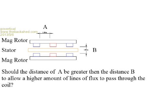

govertical
Joined: 11/12/2008
Posts: 383
Posted: 12:15am 06 May 2013
Hi, if the distance between the magnets on the same rotor is less than the air gap between magnet rotors, is there a decrease of lines of flux passing through the coils?
BlueSmoke
Joined: 02/05/2013
Posts: 25
Posted: 07:32am 06 May 2013
Hi GV,
Ok, I see what you are saying ... what type of data or literature do you have supporting this relationship of distances? I've never read anything published regarding this particular relationship.
I would have to guess that it would depend on many factors (rather than just the two dimensions). (e.g. magnet size, overall shape, cross section profile, thickness, strength, backing plates used ... etc.). Since the magnets are polarized top & bottom (N&S) rather than side faces it would seem to me that these faces (N&S) would be dominant and interact more closely with (S&N) on the adjacent rotor as long as distance A and B do not differ a great deal. (On my setup, distances A & B look to be within a mm or two of each other) so I won't be losing any sleep over it here, but ...
... if the relationship of distances A & B is of great concern then I would wonder why Pie shaped magnets that actually touch side to side (where A = 0) are often used on axial flux rotors with great success.
It would be interesting to know more but with this humble build it's really a mute point for me since I already have two rotors mounted with magnets epoxied to their backing plates. I'll certainly be keeping my air gap as small as possible, however.
BlueSmoke
govertical
Joined: 11/12/2008
Posts: 383
Posted: 10:53am 06 May 2013
http://www.femm.info/wiki/HomePage
Finite Element Method Magnetics allows you run simulations by spacing magnets and changing air gap.
On my own project I increased distance "A" to be greater than distance "B" and noticed a improvement.
I understand it is mute point now that you have fabricated your rotors, but I was curious if anyone had a similar experience. I look forward to your results.
