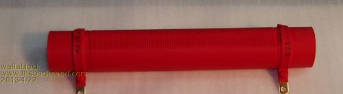

We have been through the resistor scenario in a previous post I made. Your knowledge and advise was good especially the whole temperature thing.
I have had some made previously by Hurtle Webster, an Australian company located in Tyabb VIC. They were on the dear side but the specs/ratings were perfect. Unfortunately I have moved them and the mill on to a mate so I can work on one project, and not 47 lol...

I used to order a great many special high power resistors from Hurtle Webster about twenty five years ago. Back then they were located in a small factory in Mordialloc.
They make a top product, and can custom build any high power resistor you could possibly imagine, and they do an excellent job.
But for the hobbyist, you really need to be sitting down when you get the quote.
If you are a miserable grumpy old cheapskate like me, the rusty old secondhand cast iron resistors, at about one dollar per kilowatt, are the bees knees for anything over about fifty to a hundred amps.
You can buy great armfulls of them, and bolt them together to build resistor load banks (with multiple tappings) with just awesome power dissipation.

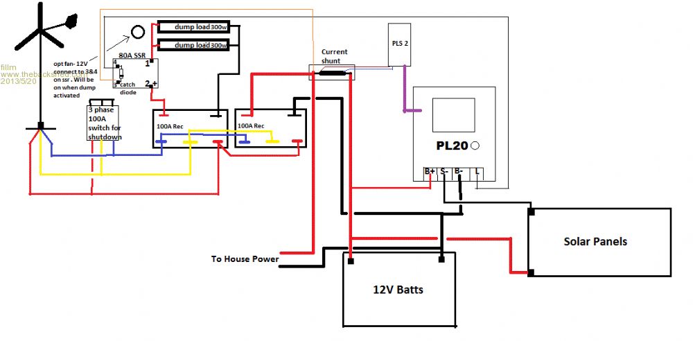

Posted: 11:29pm 19 May 2013
I honestly dont understand why you guys piss away good money on high end controllers for a windmill.
If you stop and look at what a windmill voltage controller really is, then its hard to understand where the quality controller at a high price is justified.
All a windmill controller is required to do is monitor battery voltage, and once a preset voltage is reached then the mill power is dumped to a resistive load.
Allowing for some hysteresis the battery voltage needs to fall back to a lower set voltage level before the mill is switched back to charging the batteries.
Windmills are very good at bulk charging and very poor at top end charging a battery, so it will always be a matter of too much power in good winds when the battery is 80-90% charged, when the mill output is greater than the battery can adsorb in current, meaning it will switch to dumping power early.
Then it comes down to 2 methods of dumping power.
1. is to dump power from the batteries to make room for more power to replace it, I think this is the most stupid way to solve the problem, but its the most common method used. (like killing an ant with a sledge hammer IMO)
2. You dump just the power from the mill and leave the batteries alone, hell you spend hours putting the power into the batteries, why waste it to make room for more?
The second thing that is noticed is the dump load acts like a brake and pulls the mill rpm down, and soon as a lull in the wind arrives it places the mill into stall due to the full loading, a resistor load is not like a battery that allows the mill to spin up freely to cutin speed, the resistive load is from 0.1v upwards, so it effectively brakes the mill sinking all the power it can make and turning the power into heat.
If the mill is only making 100w in stall than that is all that's being dumped.
When dumping from the batteries its high current (say 80 amp) for as long as the mill is in dump mode.( huge heat produced)
Where as dumping just the mill, its the full mill output for the period of the high gust of wind, then the mill will stall under load. (its not common to have no changes in wind speed, even in a storm), but its still has maximum loading to the mill via the resistors regardless of wind speed.
Its a simple design solution of using 2 x 3 phase rectifiers, one to the batteries and the second to the dumpload via a solid state relay (SSR), both rectifier are parallel wired on the AC side, this solves the diode loss problem of needing a in line diode between rectifier and batteries.
Nearly all controllers failures are due to switching high currents, either from the contact arcing (80amp is like striking a welding electrode) or prolonged high current through the contacts, that is why i recommend using a SSR as there is no contacts to arc as its a electronic switch, that can be switched on and off many time in a small time frame without problems. (not like relay chatter or buzzing of contacts)
conclusion.......
Add a SSR to the controller to do the heavy switching and use the controller to switch the SSR.
Use a extra 3 phase rectifier and dump the mill and not the batteries.
Pete.

It is the follow the leader syndrome I think, the last bloke did it, and the bloke before him and so on...follow the leader 'cos it works and good marketing has sold it to the masses.
I like this idea and you mentioned it a while back. The concept is very good and effective to someone who has done it and understands it, but for some it is different so I guess so it gets put the "further research required" basket.
Would you like to share a sketch diagram, SSR details and what controls the SSR?
Foolproof systems do not take into account the ingenuity of fools.

I agree with Pete on the way of controlling the power from the mill and this method "Restitive Loading " can be done with any Suitable Voltage control , there are Pros and Cons for both ways and as Pete has said Dump Loads do draw power out of the Batteries that has already been stored .
The problem is the low end controls usually only have 2 voltage set points Hi / Lo , this will be fine if it just a windmill control but if you are also putting in Solar as well as wind which most do , and you may have forked out $3000++++ for a good set of Batteries then the basic control is poison to a substantial investment, but if you are just playing around with scrap batteries and garden lights then cheap is the way to go .
Cheap Voltage controllers are a very poor way of maintaining/Charging Costly LA Batteries, one day when the novelty of checking the batteries electrolite regularly and you all of a sudden realize that the LVD on the inverter disconnected and/or you havn't checked them for a couple of months then find when you look into the top of the Batts that you can see Lead ,Its now to late is when you will kick yourself when the most expensive item "The Batteries" has been damaged and capacity severely reduced, at the end of the day you then buy a decent control + the cost of the cheap one + the reduction in battery life/capacity... Doesn't add up in my book
If you have Gel or Sealed batts, then the argument for correct Voltage control is even stronger, IMHO stay away from these types..
The PL type controls can PWM the solar input as well as switch the Windmill Relay( Resistive or Dump , SSR or Contacts ) at the set voltages for Equal / Boost / Absorb and float . By using the Resistive method as Pete has described the mill power will be diverted to a resitor bank and the mill may be stalled and the solar will then be correctly charging the batteries to 100% ( House/living load dependent )
Below is a pic of a wiring Diag I did for a customer with one of the 500W kits I sell and shows resistive loading and SSR, he is completely of grid and , note the PLS2 is not required unless the wind input needs to be added to Total Ahr/In as well . His Battery bank is Hi Quality 1500Ahr Schonhiesens , so a decent investment
* Note this mill also had the manual furl opt as it is a weekend retreat , the manual furl is pulled and the shorting(stop) switch activated while he is not there and the solar and PL20 takes care of the rest *
There is also the option to use the Gset output on the PL as a secondary dump control / generator charge start or quite a few other opts .
To me it is the smartest most well thought out and affordable and versitile "BATTERY MANAGEMENT CONTROL " on the market and well worth the investment if you are wanting to protect the "Battery Investment" .... I Don't sell them and maybe I should but I have seen them go as low as $180 SH on Flee Bay.
