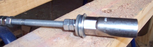

HI all, I did a neo conversion 7p2p with 10mm by 10mm 3mm thick magnets, set two high giving a gap of around .5mm
So far I have only 1 line in place.
I was considering a second staggered line.
It coggs less than the 3 phase ferrite but output was only 20 amps without grinding the stator and 17.5amps decogged.
I think we all need to measure the cogg with a test which can be replicated by everyone.
I emailed this to Glenn but I can't see it on the site yet so here it is.
Set the frame in a vice, wrap some string 2 times around the magnet rotor, tie on a 2litre bottle cut in half and pour in water till it starts to spin from a still start (I saw this on a website)
To measure the running resistance do the same thing but give the rotor a push start, keep taking out water still it stops spinning.
Take 5 tests and average them out.
I did it with the 3 phase and:
still start was 821 ml
running was 245ml
This unit gives out 17.5 amps (decogged)
the 7 phase with one line of neo's standard stator:
still start 720 ml
running 245 ml
This unit gave 20 amps
I decogged the 7 phase then
still start 675ml
running 245 ml
This unit gave 17.5 amps (2.5 amp loss decogged)
It would be interesting to see how the factory 7 phase magnets compare.
It's a crude test but it will give us some ballpark numbers. I would probably be better to weigh the water as it can vary in weight.
The output was measured with a 900 watt ryobi drill in 1st gear connected to a 16mm spark plug socket via bolted on all thread It appeared to be around 400-500rpm.

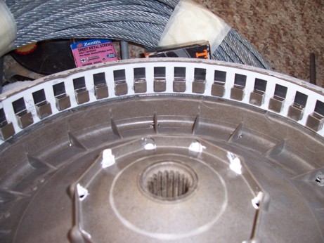

I did the water test and I think my conversion is a bit of a cogger. oh well. [20mmx10mmx3mm neo's 48 mags 7 phase].
1670 ml, nearly 1.7 kg still start.
550 ml, just over 1/2 kg running.
I could have sworn the original rotor cogged more, but maybe not.

re the water experiment. I was thinking my results were a bit extreme compared to yours.. so here are the figures. my rotor is 270 mm outside diametre with the string around the outside diametre, not the centre cog.

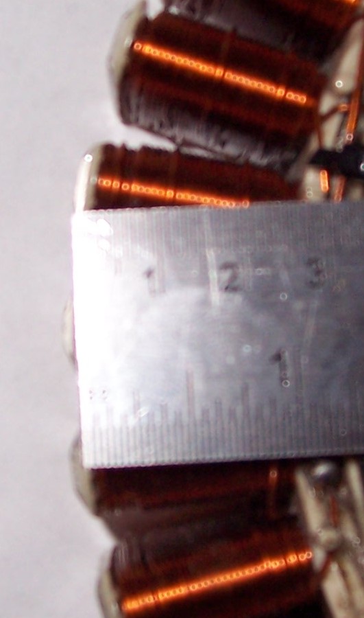

Hey Megawatt, I think I know what your saying is my drawing close?
here's a close up of the stator 90 deg to drawing
the second pic's a bit blurry like my vision on a saturday night
The metal protrudes only 1mm from the plastic former, the plastic could be filed back but the windings are only 2mm away.
Looks like a great idea but jeeeeeeeezzz a lot of work, with very precise tools req'd.
