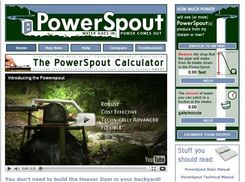

EcoInnovation Powerspout Web site.
http://www.powerspout.com/[/URL]
