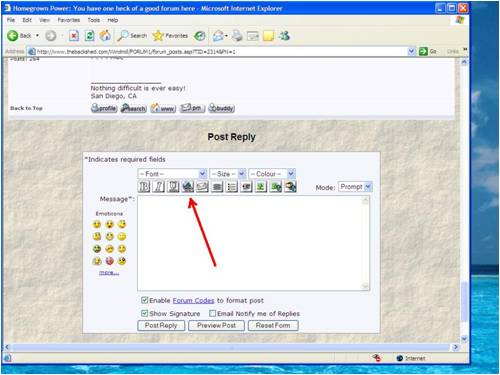

[Quote=smithbr67]Karl, I can't find the world with chain button . . .
I think KarlJ is talking about the 4th little box in the "Post Reply" box at the bottom of the page. It's the link you use to set a "hyperlink" into your post with.
. . . . Mac
Copeville, Texas
Posted: 07:29am 17 Jan 2010
This is what you are looking for.
Follow the instructions provided when making the hyperlink.
Gordon.
