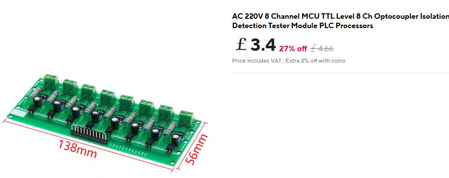

However, the control circuitry is all 220V AC and I'd want the conversion to be as simple as possible. Outputs are no problem but there are a few inputs to deal with.
Then I remembered an impulse purchase that I made awhile ago on AE:
AC INPUT MODULE:

You'd think they'd put the resistors in all the same way round, that looks so untidy. :(
Can't get a decent PCB assembler now...  :(
The price is ok though. :)
The creepage distance under that big resistor could have been increased easily and at no cost.

  Mixtel90 said  You'd think they'd put the resistors in all the same way round, that looks so untidy. :(
I share the same OCD
If I absentmindedly solder-in a resistor that doesn't conform, out it comes

I have no data to prove it, but the opto input could be slower switching than mechanical relays.

Posts: 9224
Posted: 02:38pm 06 Aug 2025
They bounce less though. :)
The "intelligent relay" controllers usually put something like 20ms delay on all inputs. Also, they scan the progran cyclically, which can introduce further delays.

  Volhout said  I have no data to prove it, but the opto input could be slower switching than mechanical relays.
Mechanical relays are quite slow and there's also zero crossover to consider.
