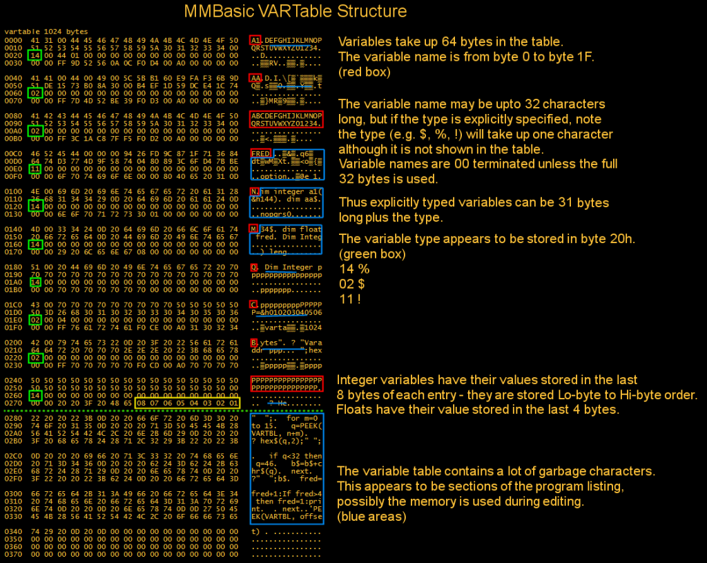

MicroMite: Unless this is peculiar to SUB, this must be a change (possibly to do with hashed variables). My code for SPLIT() routine ERASEs and DIMs an array in a FUNCTION()
h
Posted: 07:39pm 10 Mar 2025
  electricat said
Recently I was interested in varaddr etc. manipulations but I failed to find in documentation more detailed info how vars are stored.
My work was aimed at MicroMites and so I don't think it will be useful to you. I did a lot of work on this to come up with my UBOUND() function
for interest's sake...
and some code that helped
option base 0
dim a$(9)
dim integer fred
const bim=99
fred=1
for n=0 to 511 step 16
b$=""
? Hex$(n,4);"  ";
for m=0 to 15
q=PEEK(VARTBL, n+m)
? hex$(q,2);" ";
if q<32 or q>126 then q=46
b$=b$+chr$(q)
next
?"  ";b$
fred=fred+1:If fred>4 then fred=1:print
next
erase a$
fred=1
b$=""
? Hex$(n,4);"  ";
for m=0 to 15
q=PEEK(VARTBL, n+m)
? hex$(q,2);" ";
b$=b$+chr$(q)
next
?"  ";b$
next
dim bb$(5), a$(2)
fred=1
b$=""
? Hex$(n,4);"  ";
for m=0 to 15
q=PEEK(VARTBL, n+m)
? hex$(q,2);" ";
b$=b$+chr$(q)
next
?"  ";b$
next
I have discussed this on and off here - just do a search for UBOUND

I believe it'll be 17 times that for your For Next loop, currently you are only clearing 256 bytes, Peters is clearing 256*17 bytes?
Presumably the string may be gone, but the data may still be there in the unclear memory.
Regards Kevin
Edited 2025-03-11 07:11 by Bleep
Posted: 11:08am 11 Mar 2025
  javavi said  @CaptainBoing @matherp
How wasteful is the memory usage in this hash table for a microcontroller with limited memory resources?
To be clear about this - my point of reference for all this is Micromite Mk2 (PIC32MX170-based). The graphic above shows the VARTBL memory layout for that 'mite, which does not use hashed variables and is unlikely ever to do so - being considered "finished" and updates to the firmware are for serious bugs only. Each variable there takes 64 bytes in the table - I can account for around 50 of them so not that bad at all and a small price to pay to keep things a nice "CPU-sized" number.
The "worst waste" is using undimensioned strings - they are all 255 bytes long - even
A$="Hello World!"
and the syntactically accepted LENGTH is ignored for single variables. I think this extends to all 'mite flavours - anyone?
You can make things a bit better if you are REALLY low on RAM by making sure all your string variables are part of an array and then using LENGTH, but it doesn't make for easy reading and there is a tiny speed penalty. Using a CONST to identify specific members of the array can help, but it's an awful faf and arguably just moving the problem to flash storage from RAM (but this does save 500 bytes):
'very convuluted but you get the idea
Const Greeting=1
Const Goodbye=2
Option Base 1
Dim m$(2) =("wotcha","tata") Length 10
Print m$(Greeting)
Print m$(Goodbye)
In all honesty, I have yet to be seriously hampered by this and it really doesn't stop me sleeping. Birds. Birds stop me sleeping.
h
Edited 2025-03-11 21:26 by CaptainBoing

Posts: 6090
Posted: 12:06pm 11 Mar 2025
Integers and floats are 64 bits (8 bytes).
For integers and floats a reserved memory block is used (28kbyte) that is not part of the dynamic heap.
A string up to 8 characters fits inside 64bits, and could become part of this reserved memory block (so it is not part of the dynamic heap).
That is pefectly in line with Captains vatrtable analysis above (March 10 post).
Edited 2025-03-11 22:08 by Volhout
Posts: 4395
Posted: 12:08pm 11 Mar 2025
  twofingers said
  CaptainBoing said  ... and the syntactically accepted LENGTH is ignored for single variables. I think this extends to all 'mite flavours - anyone?...
I think this is only correct for PicoMites for lengths of 8 characters or more.
- Each MMBasic variable takes ~64 bytes in the variable table.
- Most of this is used by the name, type, dimensions, etc.
- 8 of these bytes are used for storage, enough for a 64-bit FLOAT, INTEGER, a very short string (7/8 chars? - but not on Micromites or currently MMB4L) or a pointer into the heap for a larger string or array.
- Space on the heap is always allocated in 256 byte pages ... hence a larger string always taking 256 bytes and the minimum allocation for an array being 256 bytes.
Posts: 4395
Posted: 12:10pm 11 Mar 2025
  Volhout said  A string up to 8 characters fits inside 64bits, ...
On reflection I suspect it is one byte containing the current length and *7* characters.
Posts: 11818
Posted: 12:14pm 11 Mar 2025
  Quote  On reflection I suspect it is one byte containing the current length and *7* characters.
Doesn't work like that. The vartbl entry still contains a pointer so nothing else needs changing. For short strings it points to the second element of the dimension array which is repurposed to contain the string
