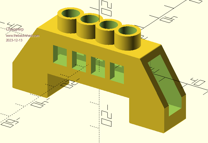

Hi Andrew
Thanks for the PC Mag ref.
I've had a Cocoon Create from Aldi for over 6 years & coming to the end of it's life with few spare parts available so I'm sort of looking for an update.
Its a shame most of the demo programs do show figurines & not practical stuff but I do suppose they do show what the printers supposedly can do.
My main advice would be to get a printer with the largest build area you can get/afford. Mine is 200 x 200 x 180mm & I sometimes I've had to turn longer slim builds at an angle to fit them across the plate or do them in parts.
I use OpenSCAD for designing my projects. There's plenty of help available for that. I've tried other programs but gave up. (Each to their own). I use Cura to actually drive the printer (slicer)
You will find that once you start printing stuff, you will think of all sorts of things you can print as well. For instance, I had a broken surround for a 4 way terminal block so I drew up another one & printed it out today. See SCAD drawing below. The item came out almost identical although I did print it on it's side.
They are good for enclosures etc, but the finishes can be a bit rough.
One thing, 3D printing is NOT fast, it can be very slow, depending on size, quality etc. Printing out 12 suitable feet will take a while.
You will need to do a few test runs to check strength etc.
Hope this helps. (Got me thinking again about a new one anyway)

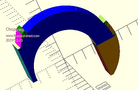

  Revlac said   I use it a lot, it will do most things we need, don't expect figurines, animals etc from OpenScad, other programs for that and probably better to use Resin printers for that stuff.
Can do interesting shapes though just using the basic commands. This one was a bit of a challenge working from a 2D drawing.
Brian
