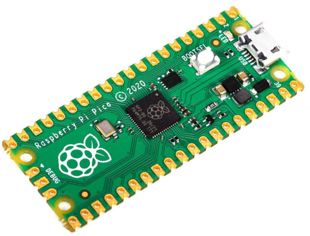

Posted: 05:54pm 02 Feb 2022
2nd question:
How do I connect an ILI9341 to the Picomite? The standard Rp2040 board with 40 pins
Where does the LED pin connect to?
In the manual I see this:
  Quote  For the ILI9163, ILI9341, ST7735, ST7735S, SSD1331, ST7789, ILI9481, ILI9488, ILI9488W, ST7789_135 and
ST7789_320 displays an optional parameter ', backlight' can be added to the end of the configuration parameters
which specifies a pin to use to control the brightness of the backlight. This will setup a PWM output on that pin
with a frequency of 1KHz and an initial duty cycle of 99%.
You can then use the BACKLIGHT command to change the brightness between 0 and 100%. The PWM channel
is blocked for normal PWM use and must not conflict with the PWM channel that may be set up for audio.
For example:
OPTION LCDPANEL ILI9341, OR, DC, RESET, CS, GP11
The backlight can then be set to 40% with this command:
Does this mean the LED pin on the ILI9341 can be connected to GP11?
or does it have to have it's own 3.3V or 5V power?
Posts: 8981
Posted: 06:51pm 02 Feb 2022
On the more recent displays the LED pin is connected to the base of a transistor (Q1 on the display) via a 1k resistor. You can connect it direct to 3V3 to get full brightness or to a digital output for On/Off or PWM control.
Early versions didn't have the transistor and an external one was needed.
lew247
Joined: 23/12/2015
Posts: 1709
Posted: 07:03pm 02 Feb 2022
  Mixtel90 said  On the more recent displays the LED pin is connected to the base of a transistor (Q1 on the display) via a 1k resistor. You can connect it direct to 3V3 to get full brightness or to a digital output for On/Off or PWM control.
So I can't just connect an ILI9341 display directly to one of these?
The manual says nothing about not being able to
Edited 2022-02-03 05:04 by lew247
Posts: 8981
Posted: 07:28pm 02 Feb 2022
The PicoMite manual describes how to do it on page 43. :)
more detail on page 48
OPTION LCDPANEL ILI9341, OR, DC, RESET, CS, Backlight
Exactly which pins you use is up to you - you set them up in the OPTION lines as required. Obviously, if you want a dimmable display you'll have to specify one of the PWM pins for "Backlight".
Edited 2022-02-03 05:31 by Mixtel90
lew247
Joined: 23/12/2015
Posts: 1709
Posted: 07:54pm 02 Feb 2022
  Mixtel90 said  The PicoMite manual describes how to do it on page 43. :)
I read the manual as you can see by the quote I took from it
What it DOESN'T say is where you attach the LED pin on the ILI9341
Or can I leave it disconnected?
Posts: 8981
Posted: 08:18pm 02 Feb 2022
You can connect it to 3V3 for fixed full brightness.
You can connect it to any DC output pin and set it high for On or low for Off.
You can connect it to a PWM pin as described on page 48 then control it with the BACKLIGHT command.
I can't tell you exactly which pin to use as that will depend on what pins are already in use on your setup. You could use, for example, GP11 (PWM5B) as it says in the manual - but not if you are already using it for something else.
If you leave the LED pin disconnected the display will remain dark and you won't see anything.
