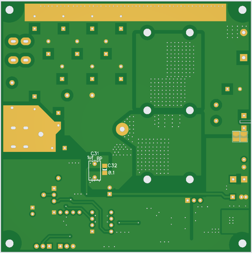

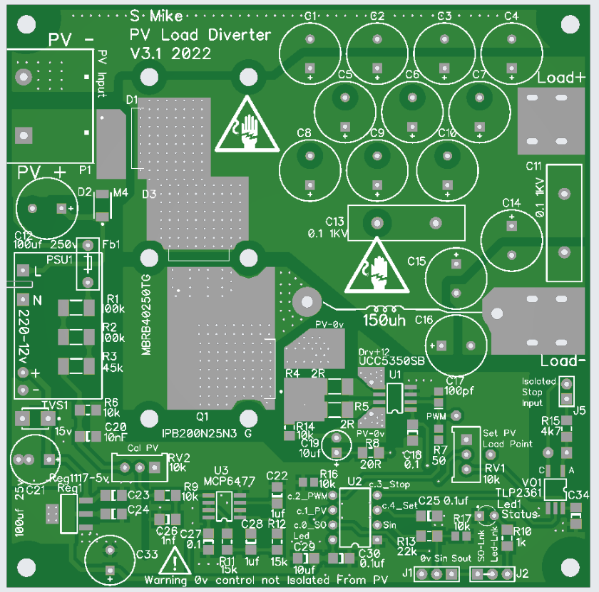

Here is first cut of the design, PCB is 100 x 100mm, the mosfet and Schottky rectifiers mount on the top layer, their few watts of heat passed to the bottom layer by the many vias, this sits on a piece of alloy + silicon insulator sheet bolted to the allow case acting as a heat sink.
My unloaded PV voltages are 200V and mppt is 155V, so the devices are rated at 250V along with the 100uf 250V caps, the inductor 150uH powdered iron ring core sits on top of the caps. 10 - 15 amps output should be ok, limited by the ripple rating of the input caps, thats why I have used 10 of them for better heat dissipation rather than bigger 35mm can types. Having 4 PV arrays and controllers means I need 4 of these diverters.

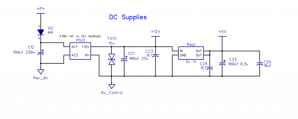

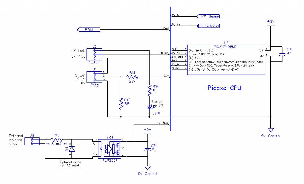

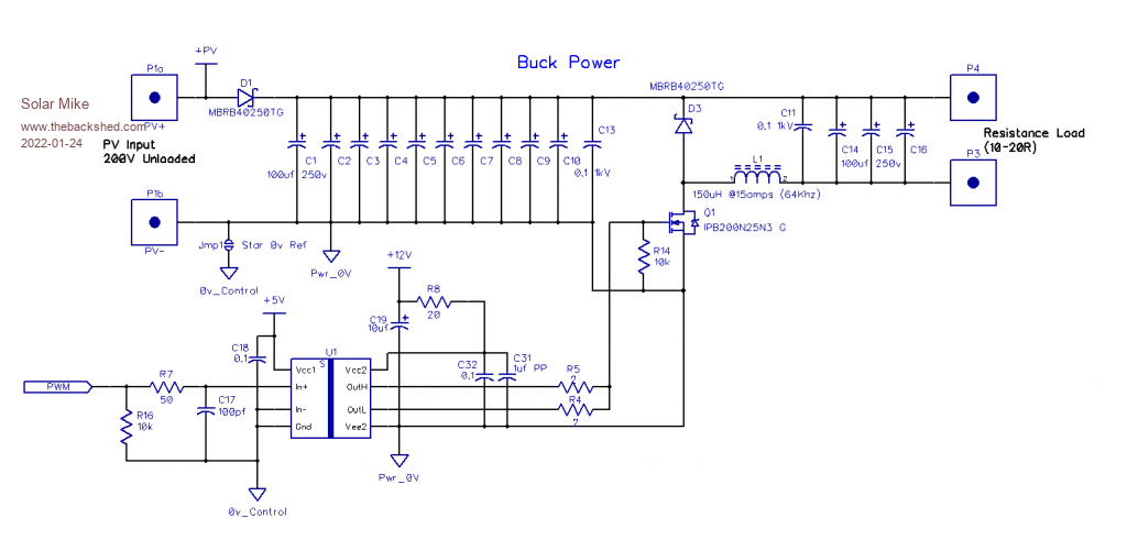

Here is the final schematic.
The buck converter has been implemented as LOW-side driver, using PV-ve as the 0v reference, so is linked directly to the PV making it somewhat hazardous for the unwary and requiring an isolated scope to do waveform measurements. All my controller designs are PV-ve 0v common so will be ok, some commercial controllers are not and would definitely require isolated probes.
Have added an extra input rectifier in the input to prevent the 1000uf of caps back feeding a possibly large current surge into the inputs of a couple of the commercial controllers in the system, they have internal input relays and I dont want their contacts burnt off.
Using one of those postage stamp 220-12v switching regulators linked to the PV input to power the electronics, it has its own 100uf cap to hold up the voltage with hugely changing PV loads.

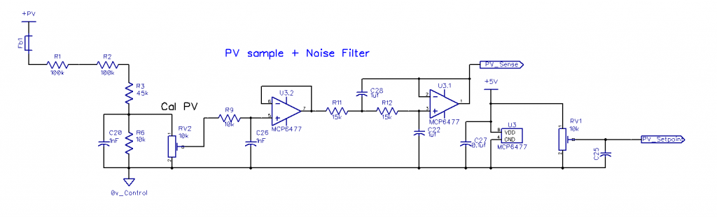

The PV input is full of switching noise, using a multi-stage active low pass filter to remove it, allows faster ADC measurements over using a single large RC combination.
Minimal CPU control required, so have used a Picaxe 08M2, will play around with differing PWM frequencies, 32Khz has 1024 bit resolution, 64Khz 512bit etc; input voltage measurement about the set point isnt too critical, so will go with as high a PWM as I can get away with - (smaller Inductor).

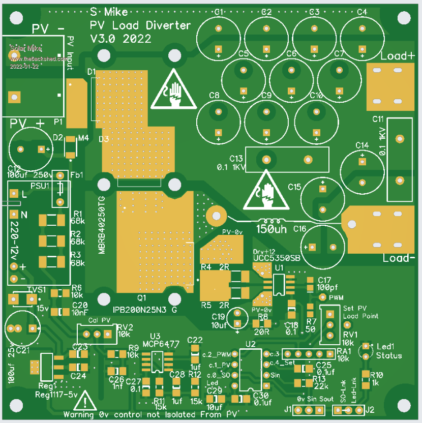

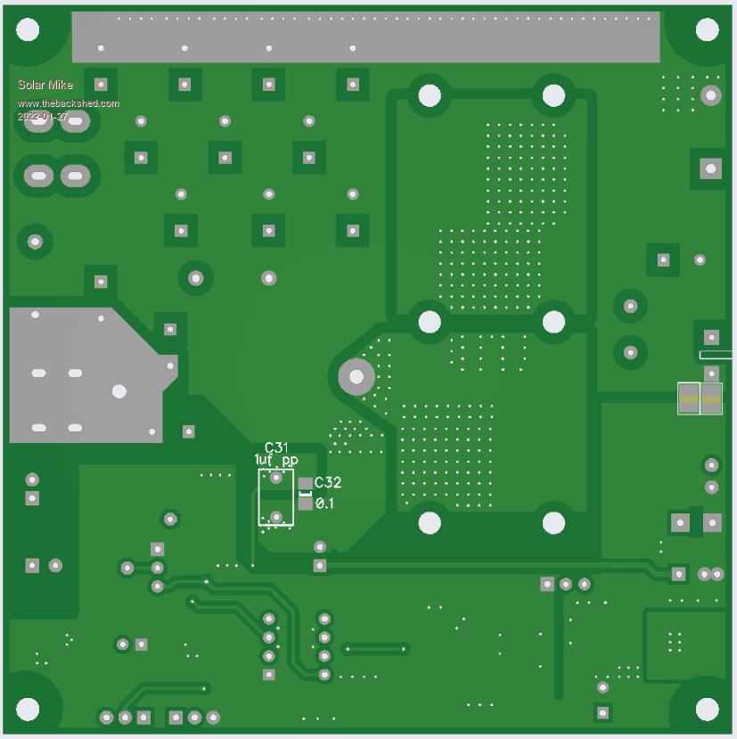

Final PCB, same size 100 x 100, have sent gerbers off to be made couple of days ago along with a batch of other designs, they may be completed before Chinese N Yr holidays:
Here are the zipped gerbers, should anyone be brave enough to build one up AND write some Picaxe "Basic" code to run it, maybe a while before I get around to building it.

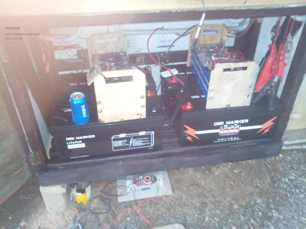

well now there is a question . I have on one house 12 panels of 250 watts about 37 volts peak I think without going to a lot of trouble . 8 amps so at best I'm getting about 8 amps at 350 volts lets say.
My inverter cuts charge when my batteries reach 54 volts and thats usually by about 10 am here. So the best hours 10 to 4 pm are just wasting .So my use would be turn water heater on when the battery gets to 54 volts and off when it drops to 53 volts I would say .
But what do I feed to the water heater ? its 240 volts .

OK . I have voltage sensitive relays that will do that. I don't have a contactor of that amperage requirement but thats easy to get .however,
My inverter is a hybrid connected to batteries and not the grid . It is also the charger . How is your inverter set up to keep producing 240 volts to send to the heater after the charging has been turned off? Am I understanding that when connected so the battery is driving the inverter ,or are the solar panels feeding the inverter direct and 240 volts then fed to the heater?
Maybe both are doing so. Could you elaborate on that please.

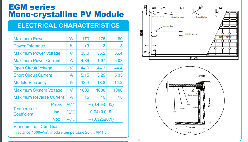

  Quote   Thats the bit that gets me !  The Mppt voltage is not set anywhere . It is a calculated figure per second or otherwise that tests the next point of voltage up and down to see if the current increases or decreases . If it goes up it moves the voltage to that step and checks the next step up and so forth until it reaches a vlotage at which point the current falls and that is the MPPT point for the time being . This is usually a routine on a microprocessor working at 100Mhtz or something .
The MPPT voltage is set by the manufacture see here on a panel I have here:
Sure the CPU continually tracks this as the max power output moves about; around the manufactures spec values, changing with temperature and available sun light; the voltage doesnt change much however and I set my trip point a volt higher than the spec.
Mike
