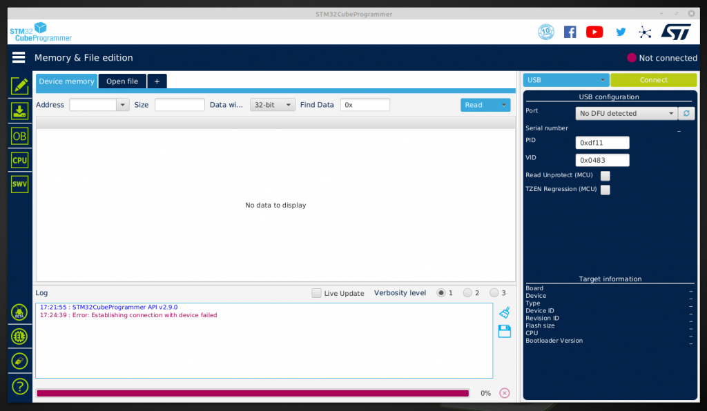

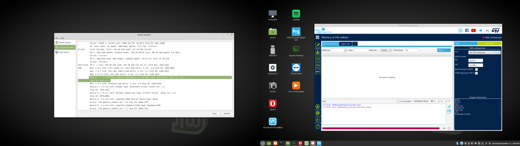

Anyway, I installed the Cube programmer for Linux just fine, it runs just fine in Mint, but it refuses to talk to a Black Pill module.

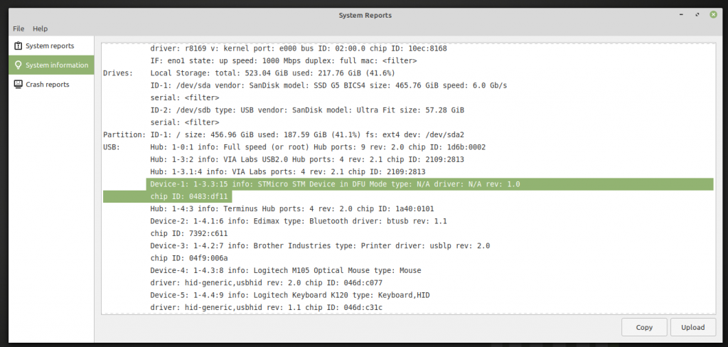

Interestingly, Mint itself CAN see the module, as confirmed by getting a system information report - see this image:
Note that the Cube programmer is looking for the DFU with a PID of 0xdf11, and a VID of 0x0483, and that Mint sees the Black Pill module in DFU mode, with EXACTLY those settings - but Cube Programmer just says that no DFU was detected.
I have highlighted the Black Pill module as seen by Mint in green in the left-side image, so I would have thought that at this point - if Mint can see the module with the correct PID and VID, that the Cube programmer should also be able to see the module at this point.
Weirdness.....
Any ideas?
I will update this thread if I ever get a reply to my request to join the ST forums, but as yet....nothing.
EDIT: Image is too fuzzy and cropped for you to be able to read any of it.  I will try to crop the image into two separate ones and upload them here.

Cropped images:

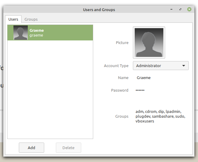

Posts: 6631
Posted: 07:00am 11 Dec 2021
Using the GUI
start
Administration
Users and Groups
select the user
Advanced settings
User privileges
Put a tick in Use modems
You might have to log out and back in for it to take effect.
(I tried using command line to do this but didn't have much success)

Posts: 10075
Posted: 07:07am 11 Dec 2021
Thanks, but no "Advanced Settings"....
Any pointers?

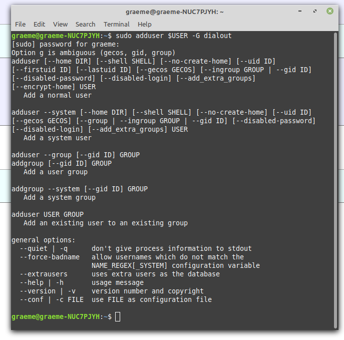

I think you'll need
sudo adduser $USER -G dialout
(using -G not -g)
Try
man adduser
to read the manual page.
Posts: 10075
Posted: 03:53am 12 Dec 2021
Hi John.
This is the response I get:
Posts: 6631
Posted: 04:40am 12 Dec 2021
You were missing the -a switch
sudo adduser $USER dialout
or
sudo usermod -a -G dialout $USER
The first version is specific to Ubuntu and derivatives
The second version should work for all Linux

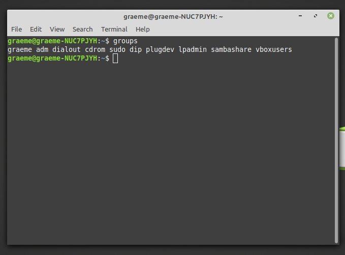

and
groups
should list the groups you are in.
Edited 2021-12-12 14:42 by TassyJim
