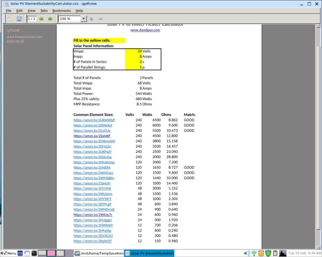

The resistance is obviously going to change with element temperature, and that depends on the type of element construction and thermal coupling into the water, and how much power you feed into it.
Only way to know for sure is to do some actual real world testing with whatever elements you have.
Trying to efficiently match the highly variable output of solar panels to any heating element directly, is not going to be possible.
You are going to need some kind of variable duty cycle controller.

Nah. -Follow the links for an understanding of whats involved. First get the element most probably suited to your MPPT voltage point . Then set up the PWM board to put out at your set MPPT point or in effect when the incoming voltage rises past that point because the battery is full. Thats where I am now but my post is looking for someone who might understand the controller I am building a little better than me. Thanks

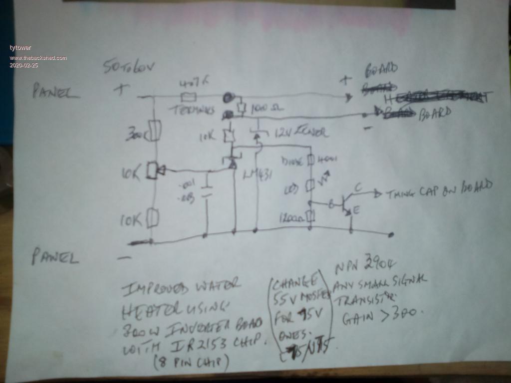

Hey tytower, its difficult to comment on what you are building without a circuit dia, your video has it covered up.
There have been numerous discussions in the past here about heating HWC element from PV panels and a number of members here myself included have built or played with the idea including postings of full schematics, circuit boards etc.
I'm aware of the "Opera House" design but have never seen a complete schematic, so cannot really comment on its effectiveness, perhaps you can contact him via his channel.

I have used and Modified  The Poz calculator and while it is helpful, I have seen that direct connecting panels  is HIGHLY inefficient up till the point where you have the same wattage PRODUCED by the panels ( not just Nameplate rating) as the element you are driving.
I was playing with this last week and the best I could get by Ohm matching was about 50% of the panels rating. When I connected the same panels back to a grid tie inverter, I got much closer to 90% rating. I would expect the same sort of inefficiency even with a low Voltage element.
I also discovered that the Voltage of the strings is largely irrelevant.  I put over 400V on a 240V element and it pulled it down to 186v or so. It’s not the volts that count it’s the total wattage that matters. The closer you get to the elements wattage, the better the efficiency you get.

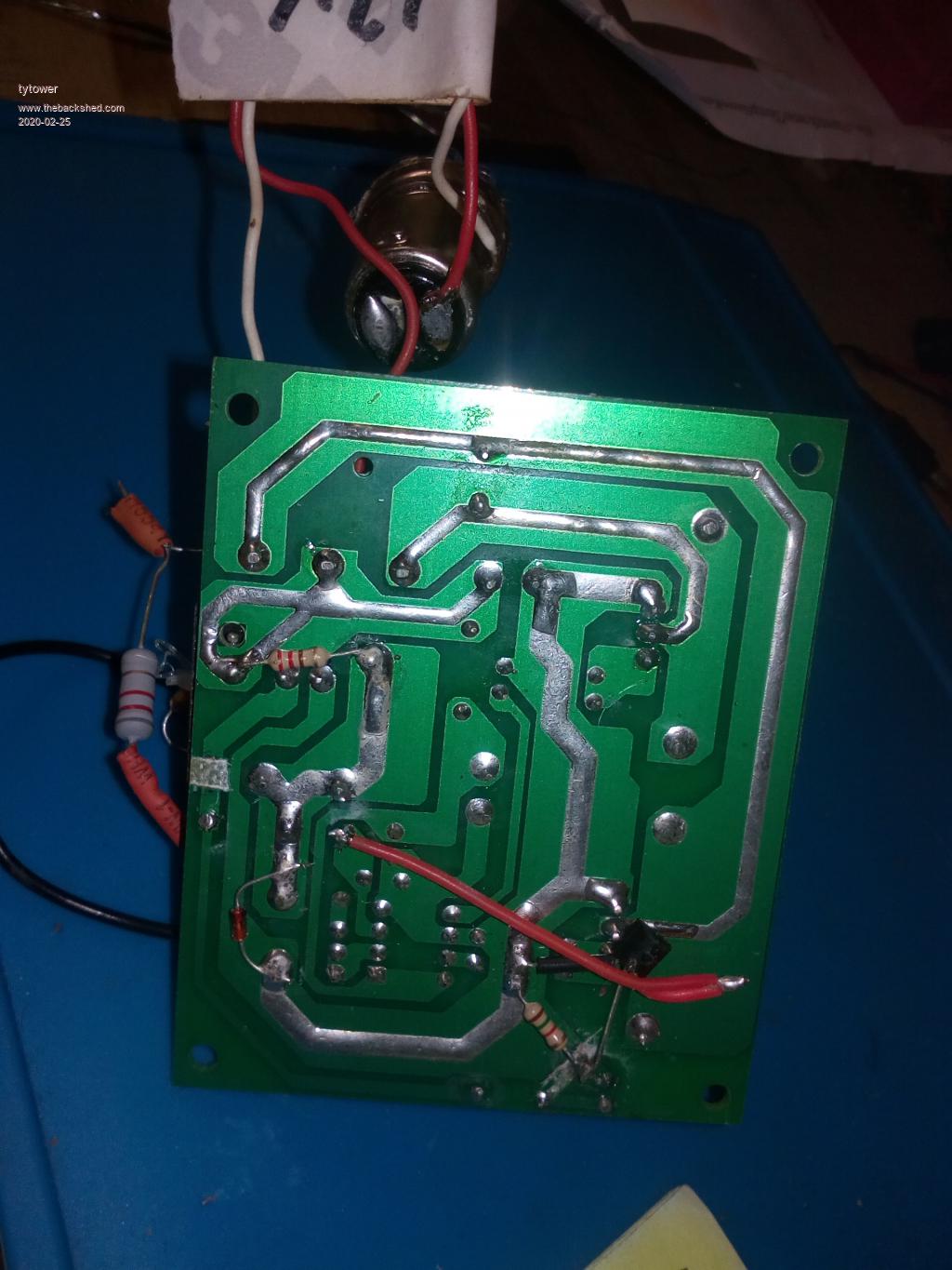

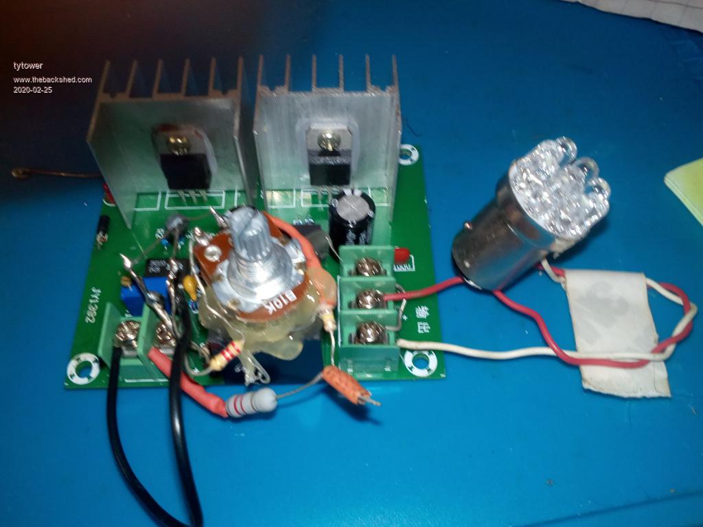

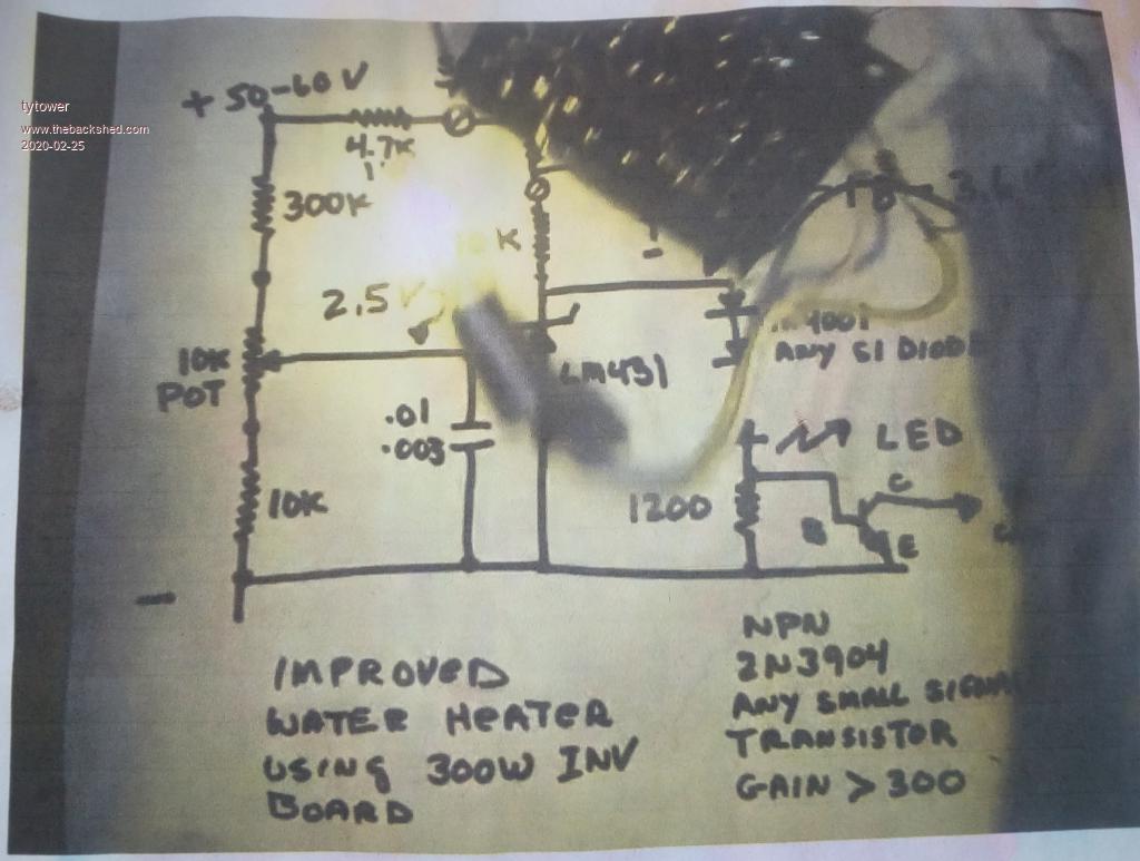

I have the controller based on his Chinese inverter board built and turning the LED on and off and with it the timing capacitor giving a voltage out . He claims to be getting 4 amps out and also another 4 amps from the supercaps . If so 8 amps at 48 Volt or so will do the job admirably.
I have a 48 volt water heater element and I've got 22 unused panels sitting aside the shed waiting for a use . I have another 12 panels feeding the grid and two more running a 100Ah 48 volt Lithium LiFePo4 alloy prismatic bank driving a 2000 watt inverter . (All panels 34Volts and 250 watts so 8 amps available with two in series.)
My batteries are full in a couple of hours each day so I'm looking at putting that excess capacity to work. That's what I was hoping to do here but as you say it seems designed to be confusing because each word he utters is carefully correct but blowed if you can read the circuit diagrams or his pics of the wiring . Here's my circuit I have built .
The LM431 device is easy enough to work out and that is just setting a point at which the timing capacitor on the board will be disengaged. That's his set point . When the battery bank goes below that point the inverter board shuts down and panel voltage goes to the solar controller to feed the batteries.From there though I'm stumped atm .
Where do the supercaps attach . I have the panel attachment points sorted. The caps probably just go across the joined up output but with a 12 Volt zener in there I am only gonna get 12 Volts out I think and that won't run the 48 Volt element. I need 60 to 70 volts coming out.
Anyway let me get the circuit and pics up here and maybe you can comment . I appreciate the effort you have put in to that answer.

  Davo99 said  Don't know if that is just a description or a misunderstanding but as far as I know they are just regular Capacitors, not super caps which are a different thing.
Well caps are caps .He is using Ultra caps I think . I have some chinese made supercaps and want to use those . I've made up a bank of them same as he uses.
8 amps at 48V is less than 400W.  How much water you want to heat? It might warm a regular 250L Tank a few degrees but that's about it. To heat 250L of water from 20oC to 60oC in 6 hours you are going to need 2.5Kw input.
Lets say you don't have a cold tank and start at 50oC, that's going to give you a heating power requirement of about a Kw.
As I said, 400W is basicaly useless. I doubt that would even make up the difference between your winter and summer water mains temp difference.
