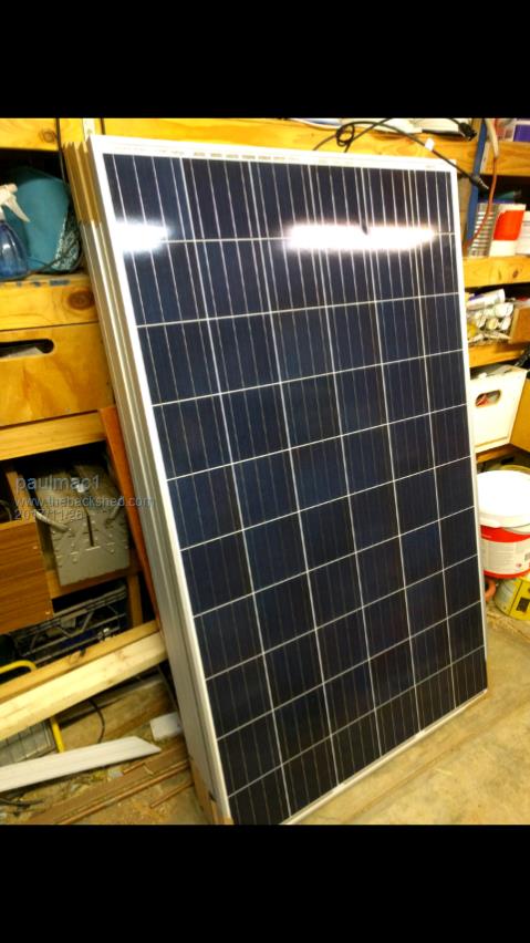

Hi all, I'm thinking of setting up a trial stand alone system for my shed.
Will these panels be to powerful for a 24v battery bank.

Unless you use an MPPT charge controller those panels won't give 250W as they will be limited to 5.57A which at 24V = 133W and at 28V = 156.
