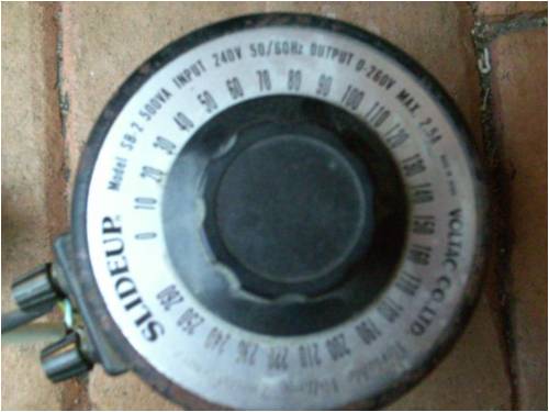

Hey Bruce, I am not sure if this is what you are after.
I have a variable transformer at home that I am not using. It has a large dial that changes volts up to about 260 volts.
I will have to check amps and get back to you, if you still want it.

Hi Robbo ,, that is a "vaiarc" ,I think .
Check the current cap ,,and I'll take a look at it maybe post a pic ?.

Wow, Great guess !
It climbs to 260 volts (from a 240 volt input ???)
Total is 2.5amps.
