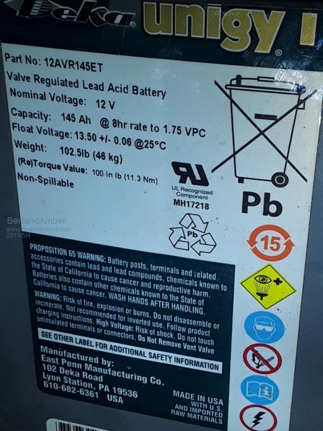

Posted: 01:19am 04 May 2019
Renewablemark did you end up getting you a forklift battery
I see Madness has got one
I read somewhere that I may only get like three hundred Cycles out of my batteries so maybe only about a year
So I am curious about other types of batteries
so I don't make the same mistake again but I did get these batteries very cheap
They are 10-year batteries
but only made two cycle very few times in that 10 years
they're back up batteries for power failure just long enough for the generator to start up
I've read somewhere that I may be able to drill holes in these batteries and add water and make them last a lot longer
so I'm very interested in anything to do with batteries on the cheap if any of you Pros have any suggestions please share them

Ben and Amber,
I've had and still got working Valve regulated lead acid batteries for around 15-20 years ,some of them I've thrown out ,because they slowly died.
So, I think you will be happy with your purchase, if you treat them nicely ..

Wow that is incredible do you have any post on how you take care of your batteries

Posted: 03:37am 04 May 2019
My banks ,3 of them , are all the same brand and Ah type ,so thats first recommendation , . then because of this I can cycle between the banks to give each a similar work time and watch their voltage-even though you may see very slight voltage drop .
apart from that ,I just feel with the palm of my hand along the fronts of the batt cases, you will notice any diff in temp ,the palm of your hand is very sensitive to temp,I've found. when I found one that was warmer ,I disconnected it and are enough , the voltage dropped fast. So--the Ol hand trick is fairly sure of something going wrong.
mine are small banks, around 200-300 Ah. -I have a battery control switch board that has those big red battery switches you see in boats on it -so I can isolate or parallel banks whenever.
( I once connected up a bank mistakenly with 3x12V ,INSTEAD OF THE USUAL 4x12V for a few hours.(48 VOLT bank)
so it was charging into 36 volts?
YOU'LL SOON KNOW, BECAUSE MY ROOM ,WHEN I OPENED THE SLIDING DOOR TO IT ,SMELLED OF THIS ACID TYPE SMELL ,AND ,OF COURSE ,I disconnected them immediately and found my mistake-that was just a couple of hours..
No apparent damage was done ..thankfully .)

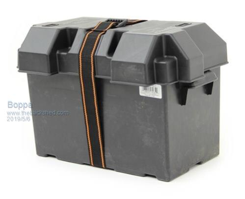

Posted: 07:26am 05 May 2019
I have taken the 3-cylinder diesel generator out
Out of the its bay to make room for batteries charge controller and inverter
This Bay is vented I'm not sure if I would have to use non-vented batteries or not
but after the story from above I better be checking into it
I know the very back smallest Bay has three very large batteries 4 starting the bus
The bays are huge you could fit a washer and dryer side by side in them and it is 8 ft wide or deep what ever you would call itEdited by BenandAmber 2019-05-06
renewableMark
Joined: 09/12/2017
Posts: 1679
Posted: 09:16am 05 May 2019
They produce hydrogen gas (which rises). (and goes Kabooooom)
They also produce a mist from the electrolyte evaporating and it's slightly acidic.
If that's in a luggage compartment of your bus then it will eat away at the metal unless you pay very good attention to venting.
I fitted a hood over the top of mine made from core flute plastic stuff. Signs are often made from this.
Then fitted a fan to extract the gasses, mine runs out the top of the garage roof.
here Edited by renewableMark 2019-05-06
