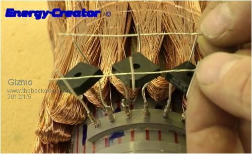

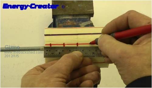

Brian sent a copy of his DVD to me to review. At first I was a bit skeptical, there are a lot rubbish DVD's out there with plans for cheap windmills, free energy motors, etc. This DVD isn't one of them , in fact I think the DVD is very good.
In the DVD Brian describes, in good detail, how to make your own alternator using magnet wire, magnets, a couple of bearings, and parts bought from any hardware store, like PVC pipe, epoxy, etc. The design is nothing special, its a typical radial air core alternator that almost anyone with windmill alternator experience will recognize. Output power is nothing special either.
So why do I like the DVD?
Well first up, the design and assembly technique Brian uses would scale easily. In fact Brian's shows how to make a small alternator capable of a few 10's of watts to a big water cooled model that could supply over a kw with a big enough power source, using basically the same process. Plus the DVD includes some templates to correctly mark out the magnet and coil positions.
Also, the DVD is a good teaching tool. Brian explains why single phase and 3 phase are different, and shows by example. He also shares a few handy assembly tips, I especially liked the tool for winding 3 phases at once. The whole DVD is full of little tricks Brian uses to assemble the alternators, a few of which I'll use on my own projects.
So yes I do like the DVD, especially for its teaching value. And I'll even have a go at making a small alternator for a mini-windmill using Brian's technique.
Below are a few screen shots from the DVD movie.
