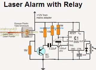

an anyone tell me what I can do to change this ciruit so I wont need the bc557
its for halloween ,and i need a 12 volt laser circuit which does switch a relay.
Thanks .

An interesting one. I think the transistor is there to ensure that the circuit only operates with a very bright light and will not trigger for ambient light changes.
If this does not matter, then I would leave out the 0.22uf capacitor, the transistor, and 10k resistor and connect the LDR to the remaining 10k resistor and ground.
This should work though you may have to experiment with the 10k resistor value maybe use a 47k pot.
Of course the circuit will operate with ANY light, you will have to test it in the dark.
Incidently, you did not say why you don't want to use the BC557.
Hope this helps.

Seconds remaining. What do you have as a photo detector? Many don't know you can use about any LED to detect light. You could connect that directly to the trigger pin. The transistor just provides a high impedance input almost any PNP would work or an op amp in unity gain.
