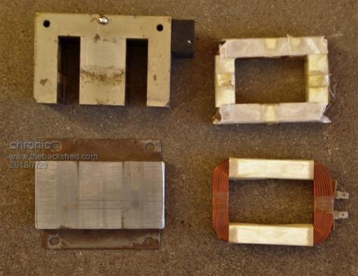

I thought taking one to pieces would mean cutting the windings, but it turned out to be OK and quite easy.
There are two welds holding the E-core and I-sections together. After a small surface cut in one weld with a hacksaw there was an audible crack as the rest of the weld snapped. The I-section then rotated off with a little effort, breaking the other weld in the process.
The main input winding removes OK with a little leverage. There are two magnetic shunts underneath it about half centimetre thick, then a winding for the magnetron filament I think - about three turns, lifting out easily.
The input winding is about 260 - 280 windings at first glance and approx 1.5 ohm according to a cheapie meter (probably not very accurate).
The main HV output winding needed a lot more pressure to remove. Eventually I stood on the exposed windings one side at a time, with some padding to avoid damage, and the winding slowly slid off.
The DC resistance of the HV winding looks like about 80 ohm, hopefully it is not damaged, it looks ok so far.
Here are the laminate blocks and main windings, there are also two small magnetic shunts which may be useful I guess.
I wonder what sort of inverter it would make - probably inefficient and heavy, but very cheap
