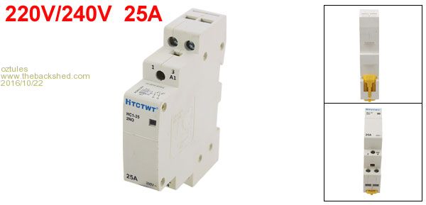

I would use this sort of relay...

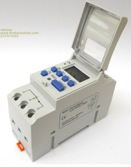

This sort of timer .... should only need one as it has multiple multiple programming. and does not forget programming when power goes off for some reason... self resets when power resumes.
I note there are some of this design that claim 20 amps, and this would mean no relay required for a 2hp centrifugal pump motor

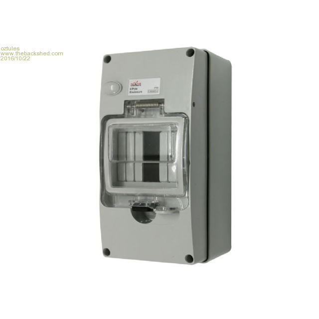

I would keep all components in this style enclosure ... and all at 240v not 12 or 24 etc.
This sort of box has water proof ratings, and it has the din rail so all the stuff will all just clip in. There is room under the rail for wiring as well between items, and gland exits too.

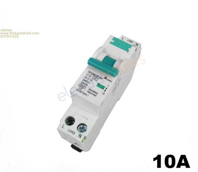

and a 1 pole rcd.... just because you can

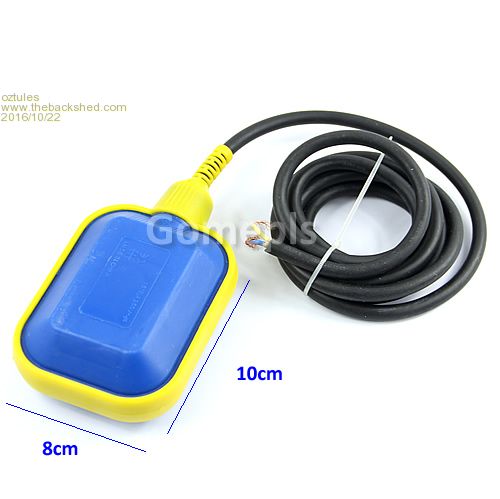

Mount on a stand pipe/pole next to pump, and a float switch of your choice to suit in another weather proof box same style would look nice.... but I would use this sort of float with no box required, and will never fail. They have natural hysterisis which may suit your requirements

This would be robust and very unlikely to fail, simple to implement, and very neat and safe.

Thanks for the photo of those float switches, I had my eye on them but could never find out if those tiny reed switches in them can carry the 15W (?) at 16VAC those solenoids require.

Those float switches are rated @ 15amps 380vac
I think they are most probably mercury switches.

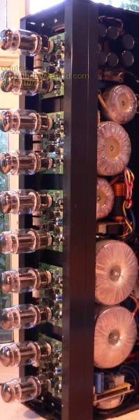

hhmmm I did quite a study on toroids when they were first released, for sound duty, as I am pretty much an audiophool, and was looking for perfect valve derived sound. Perhaps why I still use EI laminations in audio, albeit bloody big ones."
This is off topic... but I can't help it.... I like valves.
I expect torroids for the power supply would be a straight forward project, good regulation, and half the mass of an EI for the same power...as you don't need supporting steel around the core... there is only the core.... so an obvious improvement.
I would expect the problems to begin when we go to output transformers, as the torroid takes no prisoners, so perfect bias balance would be needed, and drive, but saturation would be a ever present threat at low frequencies, so the mass of the torroid may well be near as great as the EI version...to avoid saturation at low frequencies.
The torroid would not allow for any imbalance of the AC or DC in the windings..... but if you could trim it up properly.... would be the best transformer for the job.. . perhaps the C core would be the best/simplest practical solution.
I would not like to try to wind a torroid with the interleaved windings and balance for a williamson ultra linear any time soon.
