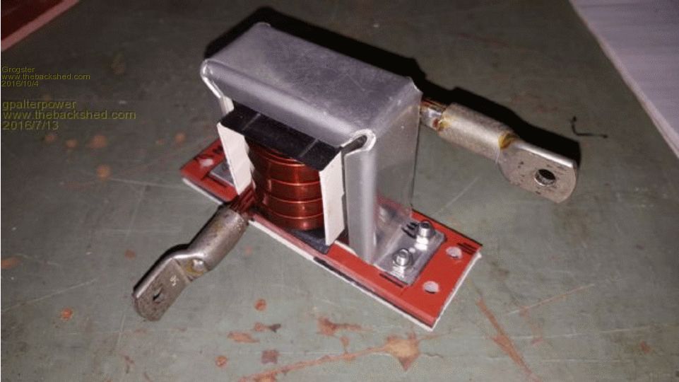

Hi Grogster,
I take you are talking about the choke between the Power PCB and the Toroid?
I see on another thread here you show the "Big Inductor Thing" in the image below.
Is that the filter in that image or the Ferrite Choke? If it is the choke it goes between the Power PCB and the Torroid primary. If it is meant to be the filter it has inductors in series on both L & N and capacitor across the output. I don't know the values for the filter, I have some Aero Sharp ones I can send you if needed.
The choke is 3.5 turns of conductor, as heavy as you can fit conductor into the core, you can get them on Ebay but took forever for the first one I ordered or from RS components and their part numbers are here.
6479351 2 Core ferrite E65/32/27 N27 7200nH
8407308 1 Bobbin E65/32/27
There is no gap, people have tried that and it works best without it and when you get it all right super glue the ferrites together. If you search through Tinkers build you will see some info there.
A useful tip is to Google Oztules and the subject you are looking for, ie "Oztules Choke".

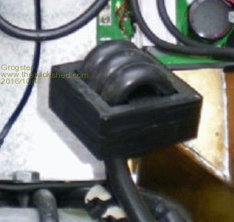

Yeah, I think I have that diagram wrong - the "Big inductor thing" is supposed to be on the PRIMARY.
I am talking about these things:
Those images stolen from other threads here.
Is it not that mission critical?
Just at least three turns inside the ferrite core?
I am wanting to know how important this part is to get right, or if it is reasonably forgiving, so long as you have one there of some sort.....
Posted: 02:37am 04 Oct 2016
Hi Grogster,
Yes, correct it goes on the primary.
I think I have the history part of this right if I am wrong can someone correct me please.
If you look on a site called Energy Matters Oztules was working on improving the Chinese Inverters that the ones we are playing with now evolved from. Those Inverters where using 200W on idle, adding this inductor was the solution to drastically reduce the idle current.
I am not sure about how critical the values are, the parts from RS are not prohibitively expensive. I have seen somewhere on a forum where someone salvaged inductors out of some old electronics.

Posted: 09:13am 04 Oct 2016
It is a tiny inductance.... too small to have any effect really on the 20khz
It is in the region of 12-20 uh.... not critical after about 12uh.. a bit more is better , too much seems to reverse the effects.
I don't know why it works so well... it may have something to do with switching losses in the fets, and this small inductance allows the switch to get fully on before the current really gets going... cant see how else it can make a such a huge difference, with such a small inductance. I think it was windspeed that promulgated this theory, and I can't think of anything better.
.........oztules

Posted: 12:38am 05 Oct 2016
If you use round cable of a decent size then you are limited to 3 turns and it works well.
If you are using rectangular enamelled wire you can fit 3.5 or even 4 turns of 60mm sq area max and it works marginally better. A fair bit of work for a small gain .
Round cable can be wound on by hand, you'll need to wind rectangular wire on a lathe or such.
Buy the cores with the plastic bobbin if you get them from e-bay.
Cut the bobbin carefully into a right and left half (see my tread "tinkers inverter build") and you can then wind your coil on a strong dummy center and insert the fragile bobbin halves when the coil is finished and then stick the lot together with epoxy.

Posted: 09:04pm 06 Oct 2016
Grogster,
When I wound mine I found that I could get nearly 4 1/2 turns on the ferrite core. I was thinking that 3 1/2 was optimal, but fitted the extra only because I could to fill the gap and to prevent the turns being too loose. My stand by current is only 0.7 amps on 24 v so im not sure if this is due to the extra turn or not but Im pretty happy with the outcome.
Now I dont know either how they work but is amazing that it does and it definitely made a difference. I tried the inverter without it jumped back to 4.5 amps. Eeeeh! Power hungry.
On another note I was wondering if the ferrite E core could be replaced by a small torroid, say bout 80mm dia. I have a spare one from a speaker amp setup and am contemplating stripping it down, rewinding with 50mm and giving one a go in my old hungry "power star" inverter as an experiment. I have read the thread from the Energy Mattery forum ...(https://forums.energymatters.com.au/solar-wind-gear/topic3344.html) site but a toroid was fitted firstly in place of the 2 E and I cores before any other changes/additions were made so I guess we'll never know if by just fitting a choke will make any difference to the idle current. When I have a spare weekend ill give it a go.

Posted: 02:19am 07 Oct 2016
Marcus
I tried the ferrite ring idea, it gives a much worse standby current than the E core.
They use those rings in Latronic inverters at the primary winding. 4 of them stacked and wound with many in hand 2mm wire.
I test wound one with 4 turns of 25mm sq cable and, as I said above, it was worse than the E core.
Hopefully your results are better.
