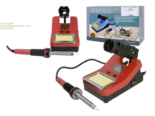

Hi just bought a soldering station that is 48 watt
Temperature adjustment range 160 - 520 deg. C
what temperature would you solder strip board on. and what size tips would you recommend. Thanks

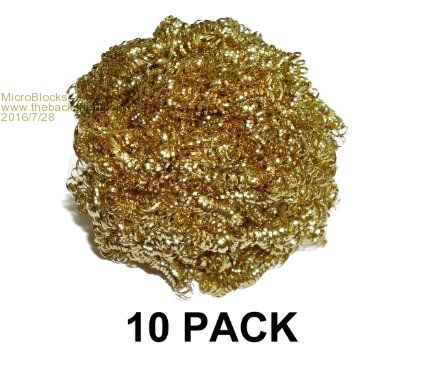

I would drop the sponge and replace it with something like this:
They cost about 7-8USD for a pack of ten and last for a long time.
A sponge will cause a large thermal shock each time you clean the tip and depending on the kind of tip this can shorten its lifetime. It also needs to heat up again and slows you down.
Since using it i never used a sponge again. :)
