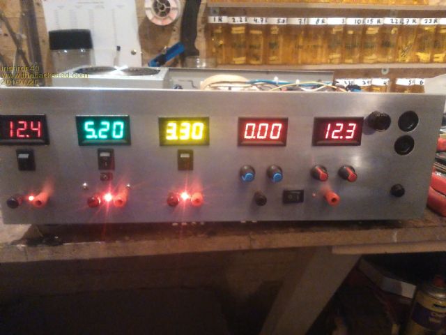

It took a bit of time, but got it finished.
Thanks for the help and advise I have received.
Its a combined psu power supply and a variable 10A 2.5-28volt power supply
casing was from an old videotape player , and I put on a aluminium Front panel.
ron

I Did Glenn. especialy to use a magnifying glass. the problem was very tiny solder bridges.
all worked out in the end.

Have you been game enough to short the output leads and dial the current up for a brief moment, to see if all works as intended.

  Quote  Have you been game enough to short the output leads and dial the current up for a brief moment, to see if all works as intended
Yes I did that and it worked Pete.
Can you just explane what stops this circuit from braking after shorting it?
I know it works , but love to know is it the lm723 that protects this circuit?
Thanks everyone.
ron

If you look at the data sheet for the LM723, I expect it will mention current limiting.
When the current reaches the level set by the Pot, the LM733 changes from a voltage source to a current source. Thus the current will not rise further.
