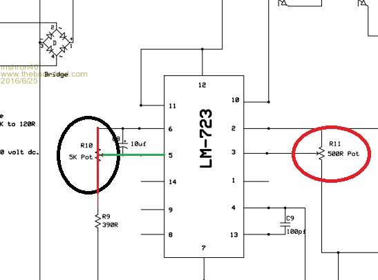

hi. im nearly finished my power supply , but am a bit confused how to connect potentiometers.
am I right to think that the potentio meter be fitted with middle leg onto red line and outerleg to green line?

Posted: 12:24pm 25 Jun 2016
Middle leg is the one with the arrow in the diagram and is the one that moves.

Posted: 12:37pm 25 Jun 2016
Hi Ron, You should have three legs on your pot. The middle one will be the green line and the outer two will be each end of the red line. Just Google potentiometer wiring, there are lots of images to describe how.
Just remember some pots are not linear. ie the rate of change of resistance changes.

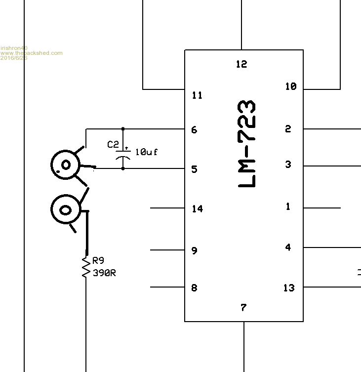

i had a look. but like to also include fine tune potentiometer for voltage and on the current control
they show a 5k pot for voltage and 500ohm for current limiter.
what size should the fine tune pots be and also what way are they wired in series. cant seem to find a diagram on google.
thank you.

Posted: 12:37pm 26 Jun 2016
I suggest you have a good read of this page it will answer all your questions.

.i read that link. but it doesnt say anything about connecting pots in series. and what vallues. is the way i drawn the 2 potentio meters the right way to wire them to archief course and fine tuning? and can they be both 5k pots?

Posted: 08:58pm 26 Jun 2016
You can use a precision trim pot for fine tuning, that is their purpose. They are available in models that have a have lot more turns allowing very fine adjustments.Edited by MicroBlocks 2016-06-28
