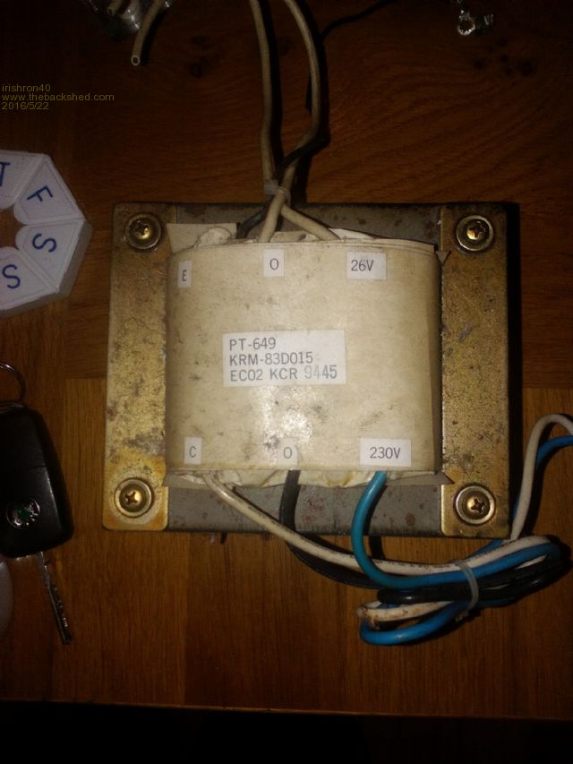

Hi. I have a large transformer which is able to give me 38vdc
It came out of a VP-1240B Power Amplifier
can anyone tell me what amp output this transformer is able for?
I think its able to supply 15 amp, but not sure

Posted: 02:08pm 22 May 2016
Were there any fuses on the input or output? The fuse rating would give you an idea.

Posted: 02:14pm 22 May 2016
Thx Glenn the fuse was after the 2 rectifiers and is rated 20A
Transformer is about 6x6 inches in size. quit heavy too
ronEdited by irishron40 2016-05-24
Posted: 02:30pm 22 May 2016
In that case it should handle 15 amps then. Just keep an eye on its temperature.

Posted: 04:07am 23 May 2016
  Quote  which is able to give me 38vdc
On average the DC output is calculated from the AC output like this ...
26VAC x 1.4 = 36.4VDC
So your 38VDC is in the ball park but might not be sustainable under load.
I too would think you should be able to get 10 amp or above from the transformer.
Note the circuit design presented is only rated to 10 amp, and at that high current you will need LARGE heatsinks on the transistors.

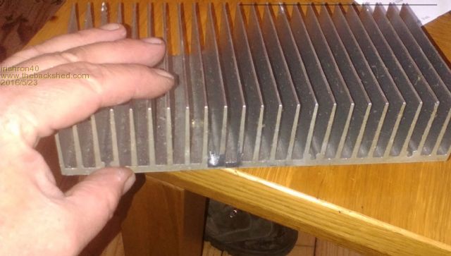

thx I think this heatsink should be large enough to handle those resistors
Posted: 02:12am 24 May 2016
Actually its about the ideal size, being about twice the size you need for 10 amp at 35VDC input.
It is the Transistors mounted to the heat sink and not resistors, although it wont hurt to also mount the 10W resistors on the H/s.
