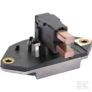

Posted: 02:49pm 17 May 2016
it is not charging.
the regulator should be floating the battery close to 13.8 volts when it is fully charged and running up to 14.4 volts under load.
I have got a feeling that the brushes and controller are in one module on those fiats. it pays to check that the power wire onto the module is getting power when the key is on and the earth (probably via one of the bolts) is not crusty before you go to town on the brushes.
