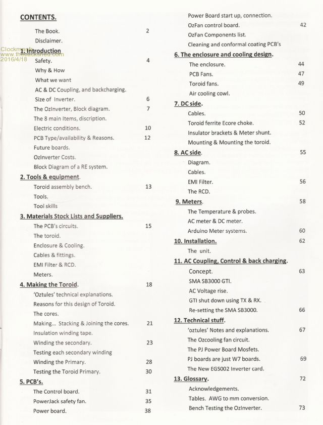

The new 6kW-15kW Power board, 282mm x 174mm, 2 oz copper, I have put together is based on the single PCB PJ Power Board but modified with more & different components to match the new OzControl board. ie they are a matching pair.
I have beefed up the Power Board in appropriate places, but really tried to keep things simple, robust and cost effective. (So any one on this Planet can put the things together without specialised gear).
The book is printed, but I am awaiting the PCB's now so that I can add a addendum pull out.
This will contain real size PCB masks, ready printed as a DIY for your own boards. These are slightly different and have no solder stop masks so they can be tinned and small straps soldered on, that's if the person can not readily obtain 2oz copper boards.

The Book Index....

Posted: 12:59am 18 Apr 2016
Hi there.
Book loooks FANTASTIC!
Well done, you.
I know where you are coming from on the PDF, and I also think you should NOT offer that at this stage. To paraphrase you for a moment, it is really easy for anyone with a flatbed scanner to scan a printed copy and start selling off electronic copies of something they did not even write.
Ill-gotten gain is what it is all about to some - it sucks, and I totally understand your reasons.
I would like to purchase a copy of the book though, when you are ready to sell.
